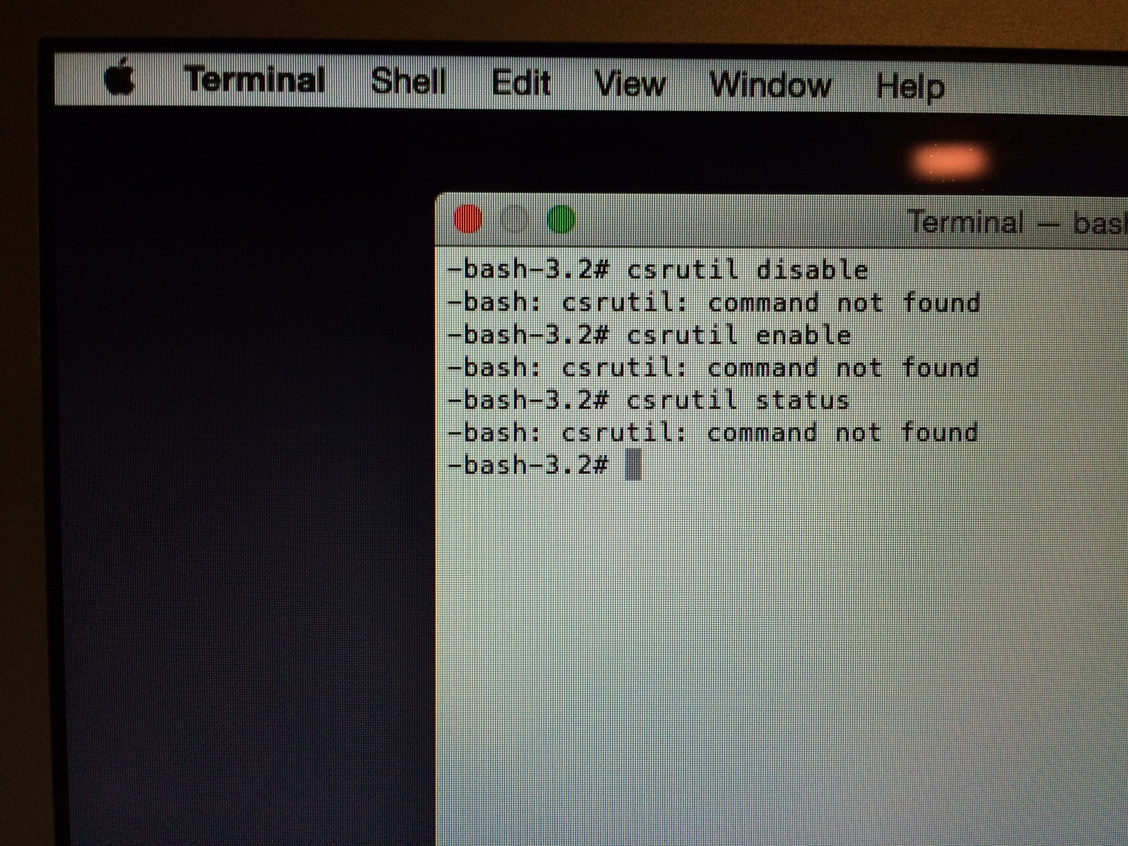

Hello,
After 2 days of trying to upgrade my Mid-2011 13" MacBook Air from Yosemite to El Capitan, I finally managed to have it up and running (after over 10 re-installations/system restore/clean install tries).
So I have a Dell UltraSharp U2413 attached as an additional external monitor, and after each OS upgrade, I have to re-force RGB mode to enable the picture quality to be clear. However, I found out with El Capitan's SIP feature, I have to enable rootless, as per instructions here:
http://www.ireckon.net/2013/03/forc...ix-the-picture-quality-of-an-external-monitor
However, the csrutil command appears to be missing from my system. I took a screen shot, and attached here.
Background:
1. For my first upgrade/installation attempt of El Capitan, I rebooted into Recovery Mode after the complete install, to disable csrutil. That function appeared then. Subsequent attempts to reinstall El Capitan, csrutil command seemed to have disappeared.
2. My most recent successful (12th attempt) installation of El Capitan, I resorted to this thread and followed his advice to move 3rd party kexts to another folder:
https://forums.developer.apple.com/message/67556
So, is there another way to disable SIP? Or how do I go about to re-instating the csrutil command?
Thanks!
You have to access Terminal in Recovery mode to turn on/off SIP. Is this what you're doing?
sorry, just re-read your post. I saw you did that already
I’m a bit confused why you installed El Capitan twelve times. So, to clarify: you downloaded El Capitan from the App Store, opened the installer, let it do the preliminary installation of El Capitan, reboot and continue the installation. After the installation was complete, you rebooted into Recovery and used csrutil, which worked. Then you reinstalled El Capitan again (from Recovery), rebooted into Recovery and the csrutil was gone. Then you did that eleven times, without success. Correct?
When you open the installer application on your Mac and start the installation, it will update your Recovery partition. Then it will reboot and kickstart the installation from your Recovery partition. This has succeeded, as you were able to access csrutil afterwards. It doesn’t make sense why it disappeared afterwards, because you only reinstalled the system from the recovery partition.
I don’t think that there is a straightforward way to reinstall the Recovery partition. Have you tried starting the installer from your Mac once more? It will always install the Recovery partition first, then it wil reboot and start the installation from the installation files on the Recovery partition.
Do you use a internet recovery or a local recovery?
Their Mac is from 2013 and the screenshot shows a UI of Yosemite or El Capitan. Internet recovery would have shown the OS their Mac shipped with.

to the OP : did u fix that already? maybe your recovery partition is not for el cap, hence the missing cmd.
if you have nvram, try adding this key :
csr-active-config w%00%00%00
that should disable SIP on 10.11 retail.

If you held down Command-R to enter the Recovery OS, you might have booted into the Yosemite one, which does not have csrutil. Instead, try holding down Option and selecting the one for El Capitan.
Try running:
Code:
/Volumes/*/usr/bin/csrutil disable
This way the command will be found even if it doesn't exist on your recovery partition as long as you have El Capitan installed.
