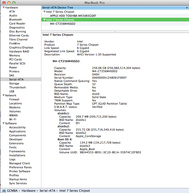

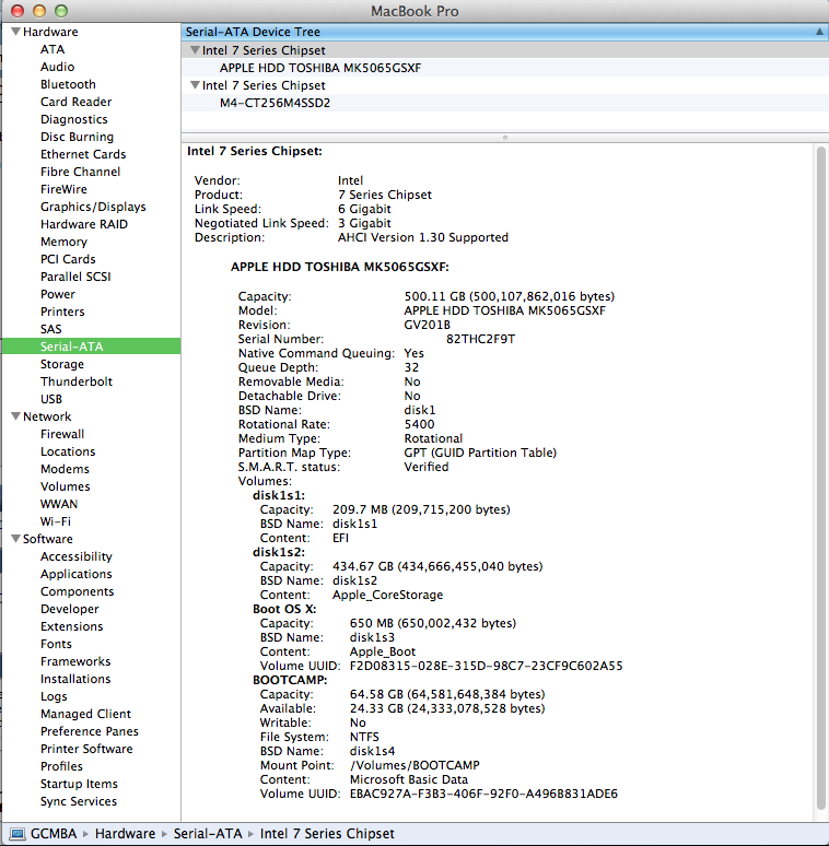

I have a 2012 13" MBP and have recently installed a Crucial M4 256gb SSD in the Optibay using the $10 caddy from Amazon. I then booted to the HDD and formatted the SSD. Then I booted to a Mountain Lion bootable USB stick and used Terminal to create a Fusion Drive, and reinstalled OSX on the Fusion Drive. Everything is running super smoothly... It's like having a 756gb SSD!
So just to get this clear; I just ordered a 2012 15" MBP and am going to also pick up an SSD. The consensus is that I can and should put the SSD in my optical bay because it supports SATA III? This SSD is going to be my main drive where the system will boot from, and I will use my stock 5400rpm drive to store media files which will be in the original HDD location. Is this correct? I have gotten some mixed advice.
So just to confirm you're running an ssd in the optibay and it's working at full speed? did you have to tweak anything to make it work because i've heard the 2012 13's didn't work well with ssd's in the optibay. Thanks in advance.
Yes, the SSD runs at full speed in the Optibay, and I didn't have to tweak anything. I heard that some of the early 2012 MBP's required an EFI update, but mine must've come w/ it out of the box (bought in late October).
See attached screenshots for proof (the SSD is running at 6 Gigabit).
