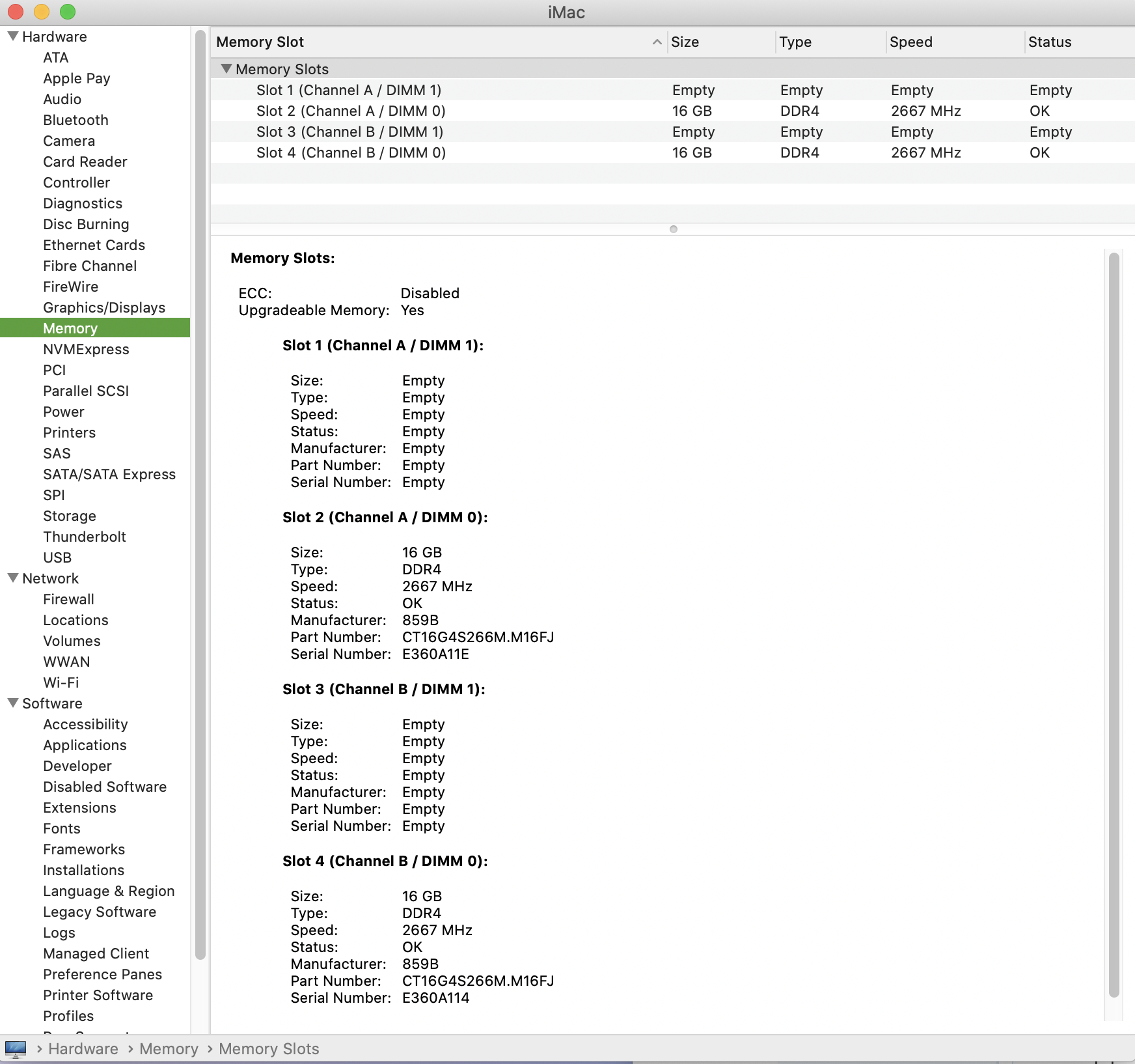

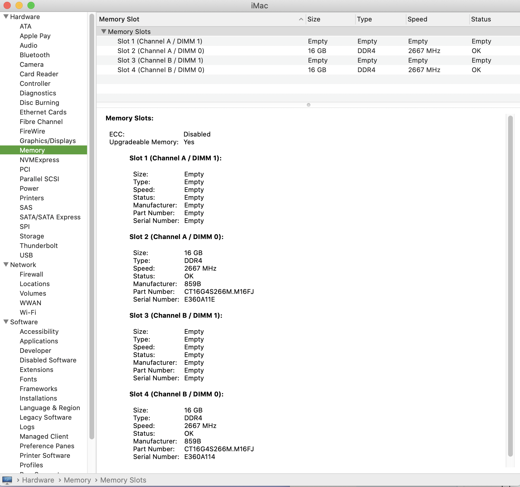

Just to be clear, if I only have 32GB (2 x 16) and don't use the original 8 (which it seems like I should do), do the sticks go in slots 1 and 2 (both in channel A) or 1 and 3 (which the summary in the thread getrealbro cited me to states). I have a friend that has his set up like the attached (which seems to be what you suggested above by stating "empty B ... empty B), but the other thread (which you also commented on) says that with 2 sticks putting them in either the odd or even slots was better. Obviously I could test both when the machine gets here to see which gets better results.
Sorry to be a bit dense. :rolleyes:
That screenshot is the wrong way to do it, and loses dual channel.
The machine comes with the Apple sticks in slots 2 and 4. You should take these out and put your sticks in the same slots from which you removed the Apple sticks. Like this:

It should work also to put them in Slots 1 and 3, but when I tried that it wouldn't boot (maybe for a different reason). The safest is to put them in the slots that Apple did.
OK. That's what I thought. I'll do that when mine comes. I'm not sure why he did that. I just assumed the original RAM came in those slots and he just replaced them, but obviously that's not the case. I'll suggest that he change the configuration.

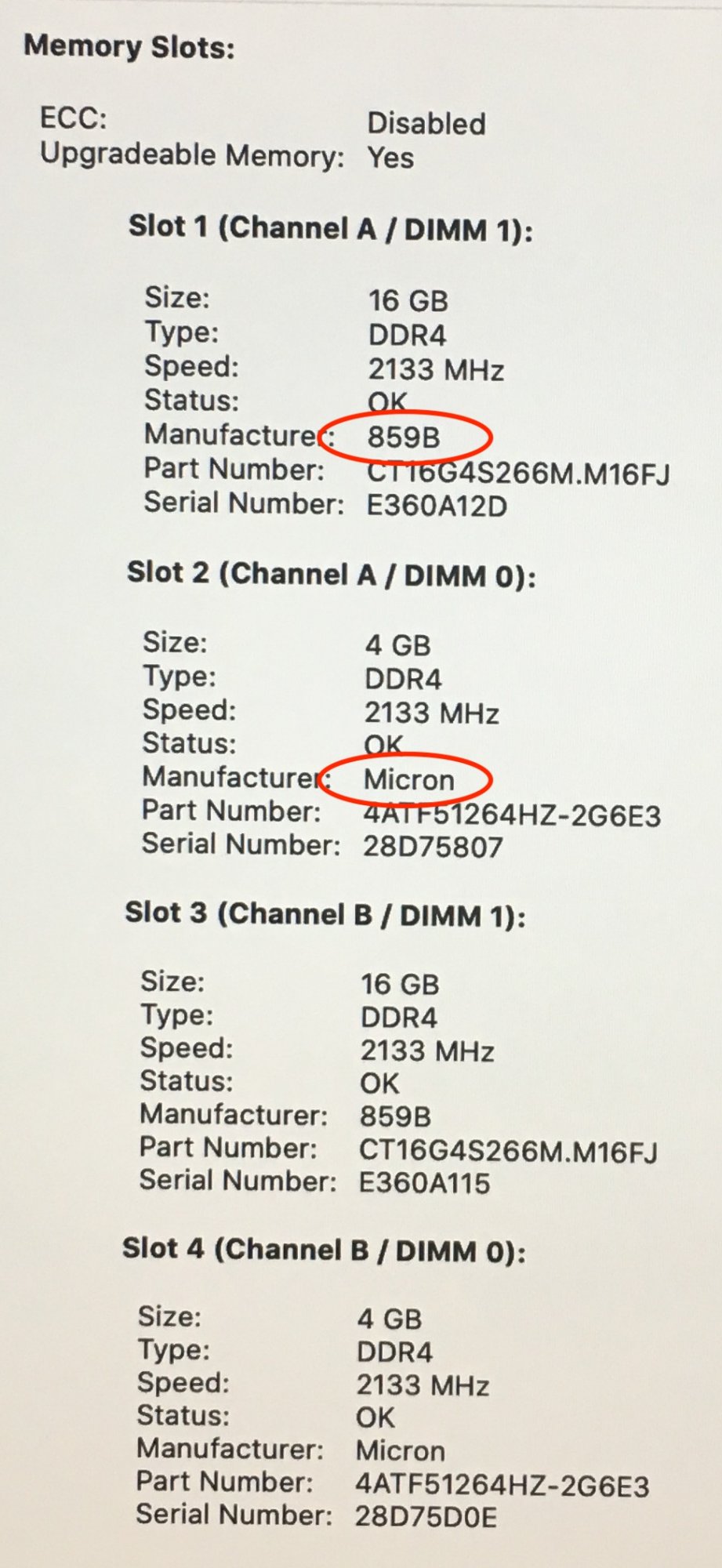

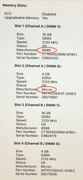

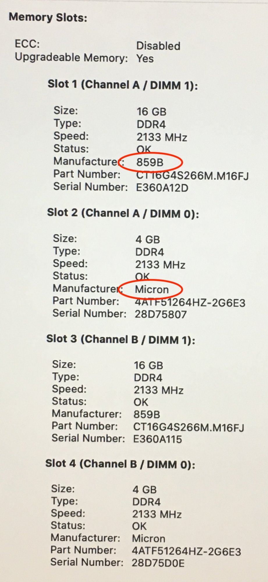

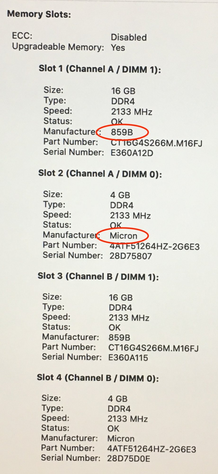

Looking at your Memory Slots screen dump reminded me that when I added 2 16GB sticks of Crucial RAM they had a Manufacture code of 859B while the Manufacture code for the 2 4GB sticks of “Apple” RAM was Micron.
I’m wondering if this memory configuration speed glitch can/will be fixed with a firmware update?

It almost certainly could. It could be set to accept and run faster RAM too since Windows recognizes the faster RAM (at least according to TallyHo on YouTube). I’m generally doubtful that Apple would issue a firmware update to fix the RAM stuff — it doesn’t seem to be in their best interest. That said, since Apple ships machines with different RAM manufacturers (some are SKhynix and some are Micron), it’s possible that this may create problems with the RAM modules Apple sells directly (at insane prices). As a thought experiment, if I decided to spend $800 on 32GB of RAM at my local Apple Store (2 x 16GB sticks) and then it turned out to be a different RAM manufacturer than what my iMac came with (let’s say I had Micron and the store modules are SKhynix), that’s a problem when the ensuing installation either leaves me with RAM running slower or not in dual channel.
Now, sadly, I no longer actually trust the Genius Bar to employ people who a) know what dual-channel memory is, b) know how to check for dual-channel, or c) understand general RAM speeds — but assuming you did manage to find someone who understood those things, sold the RAM from the store, and did the upgrade in store, that could create some frustrations if it meant the Genius had to source other RAM to either replace the initial RAM with (so they’d match) or to have to cold-call other stores to see who made what modules are on the shelf. Do I actually think that hypothetical would be enough to encourage a firmware update for the logic board to be less picky about RAM? Honestly, no. But it’s the only thing I could see that might encourage some sort of fix.
Alas, I think we're just going to need to remind our friends and loved ones that the 2020 iMac is sensitive and that you need matching brands. Oh, and not to follow the terrible advice from 9to5Mac on disabling dual-channel just so clock speeds check out.
