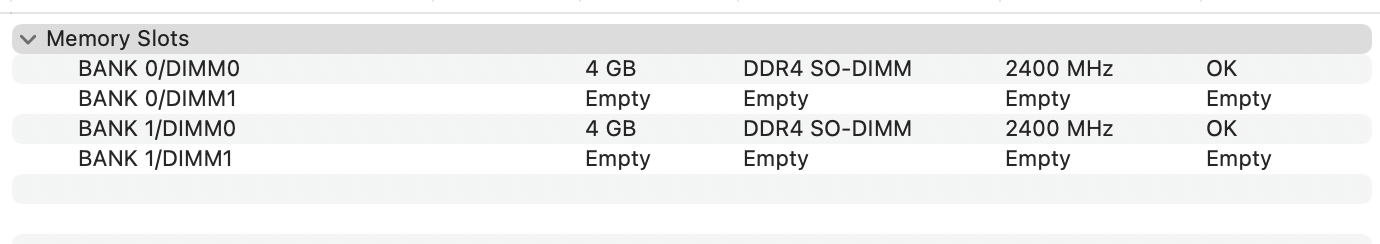

I have a 27" iMac (2017) that has the stock 8GB of RAM, slotted like this:
I found a good deal on a stick of Crucial 16GB that was open box on Amazon and snagged it. What is the best way to do this? If I put the new stick in slot 2 (BANK 0/DIMM1) for instance will that work properly or will it mess something up? Or would it be better to yank both of the existing sticks out and just put one 16 GB stick in?
Should be fine if you just add it. RAM will drop to single channel mode. But the benefits of 24GB in single channel outweighs 8GB in dual channel. I see no reason to remove the existing 8GB. As it is unlikely to conflict with the new memory. Which is pretty easy to determine since it won't boot. In which case you pull out the other memory.
Just be aware. Memory can require some force to install. So, if it doesn't boot. You may not have inserted it fully.

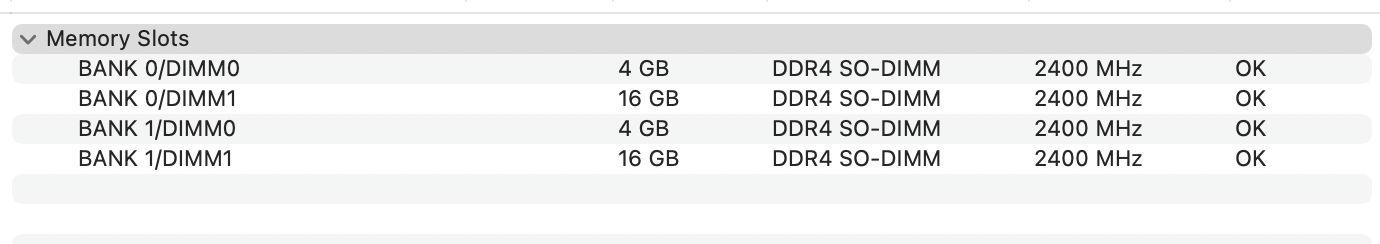

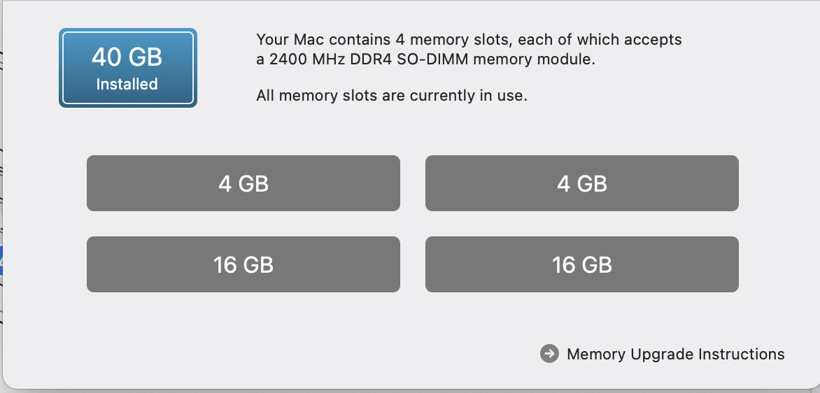

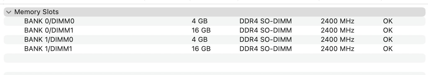

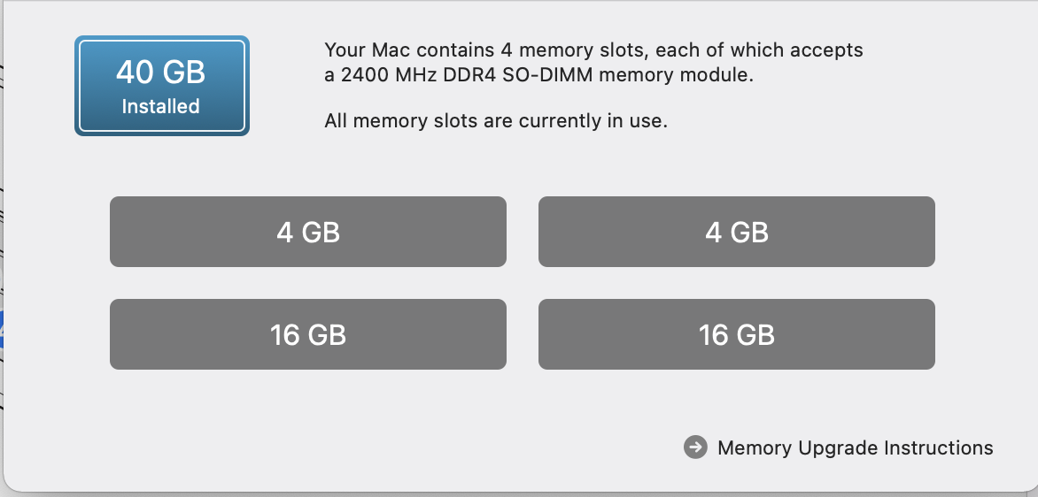

I ended up getting 32gb of RAM (two 16GB sticks) from OWC. Is there any problem with the slots I put it in? Again, this is 2017 iMac 27" (iMac 18,3).
It's all working and recognized. So, no there is no problem with the slots you used.

If you're worried. 9 to 5 Mac is showing a screenshot of RAM just like yours in the 2017.
I expect whatever you came across means BANK 0, DIMM0 should be close or better yet match BANK 1, DIMM0. Along with BANK 0, DIMM 1 matching BANK 1, DIMM 1. Which yours does.
Reactions: TitanTiger
Ok. I saw some note on the 2020 iMac that said to try and minimize the size difference between the modules in slots 1 and 2 and the ones in slots 3 and 4. But it didn't say that for the 2017 so I just wanted to double check.
Correct, on 2020 iMac (which I have) it is has a quirk where memory speed degrades unless all slots have exactly same size sticks.
There is no such quirk for other iMacs. Your slot order is good
