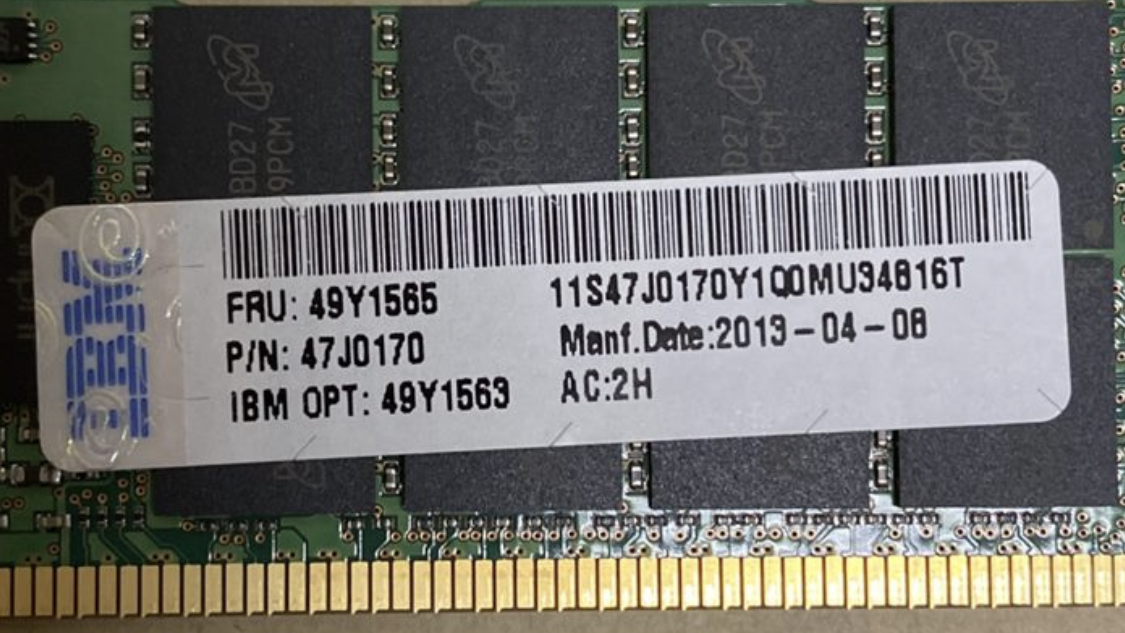

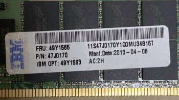

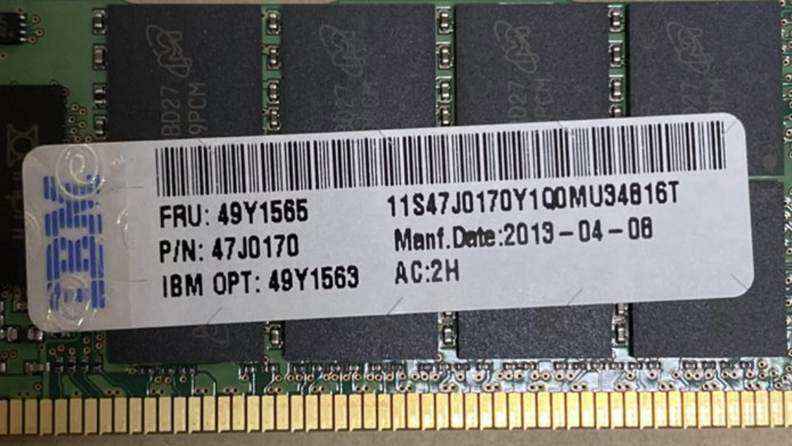

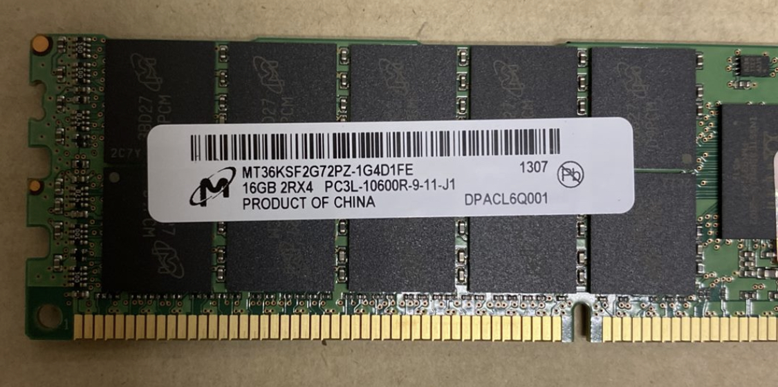

I’m looking at two IBM ram sticks on a local auction site. I can’t tell if they’re U- or RDIMM. Can anyone confirm which one they are from the labels, and if they would work in my cMP (see

This is mine and will that RAM work with this?
Should work
