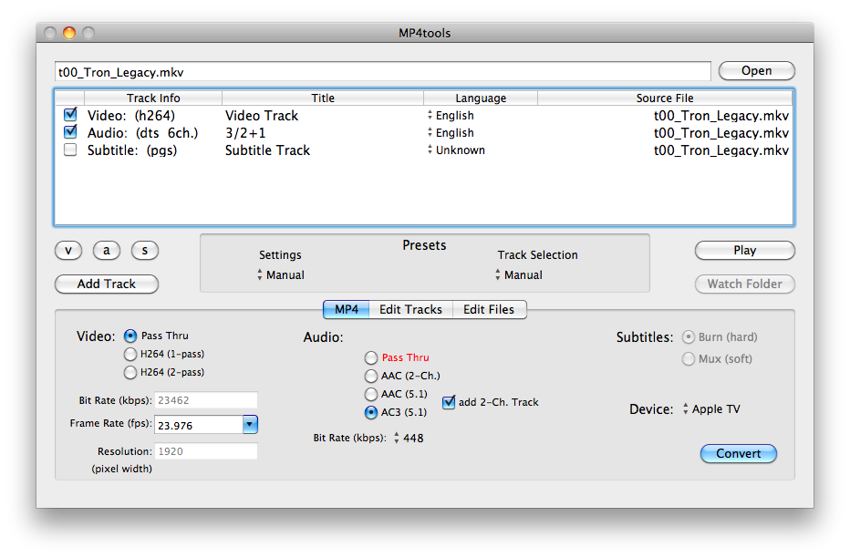

Please help a newbie here. I'm wondering if there should be some adjustments to the video frame rate, and the audio bit rate for my "soon to arrive" ATV3. Does this look ok? Isn't the audio bitrate to high? Should I use 29.97 for the frame rate?
Don't change the framerate. Audio would be out of sync.
BTW, if you want to keep the subs, you can check those and choose mux (soft). This would allow you to turn subs on/off during playback.
