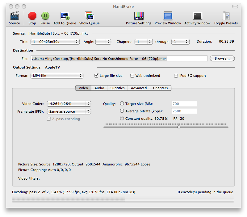

I've included a screenshot. What's going on here?

Umm, new problems guys. The videos converted Handbrake doesn't have any subtitles. I checked "Burned In" and "Default" and they still don't show up in the MP4 file. Doesn't happen with Air Video, everything just works without me worrying about the settings...
Help?

Thank you very much, really appreciate it, but I noticed you use an MP4 file. I can't get the subtitles to show up if it's MKV + softsubbed ASS. Can you tell me how to get that working with Handbrake? I checked "Burned In" and "Default" and they still don't show up in the MP4 file. Doesn't happen with Air Video, everything just works without me worrying about the settings...
I tried it with a MKV file, same results I got a file with subtitles.
I think you are shooting yourself in the foot by selecting useless options
all I did was choose the default iPhone 4 settings (google handbrake iPhone 4 settings) and then just select the iscreen size (960w), then decrease the video bitrare to 1800kbps per second
the subtitles should auto detect you shouldn't have to select anything like burned in or default
also it's not worth it to encode the file as 1280x720 (720p) since the screen size is only 960x640. it's a complete waste of time storage space
Thanks for these. I tried them out and they still take about 40 minutes, and the filesize is hideous. The original file was 250MB and the converted was 700MB! Also, the subtitles aren't appearing.
In the handbrake video tab you can choose the bitrate amount, quality level or the actual filesize you want the clip to be. I normally convert 4.7GB mkv bluray rips using handbrake and I always set the file size to 1GB for movies less than 2 hours and they always stay at that size (it auto adjusts the bitrate) and they look great on my iPhone 4.
Simply set the file size to 250MB (or whatever you want) and it will be fine.
