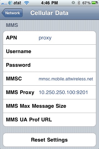

I just got MMS working on the 2g iPhone for AT&T Blue mMode (for those on AT&T prior to becoming Cingular (orange)) using the following settings:
attachment.php
MMSC URL: http://mmsc.mobile.attwireless.net
MMSC Proxy: 010.250.250.100
MMSC Port: 9201
Other possible settings besides what I used includes:
MMSC Proxy: 010.250.250.055
MMSC Port: 8080
MMSC URL: http://mmsc.mymmode.com
MMSC Port: 9201
MMSC Port: 8080

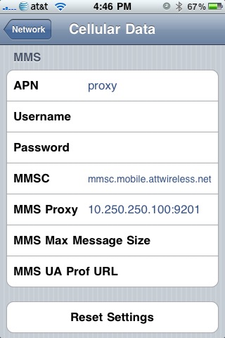

attachment.php
MMSC Port: 9201
MMSC Port: 8080
MMSC Port: 9201
MMSC Port: 8080
You have to use a URL in the MMSC section? Thats way different than my tmobile settings.
