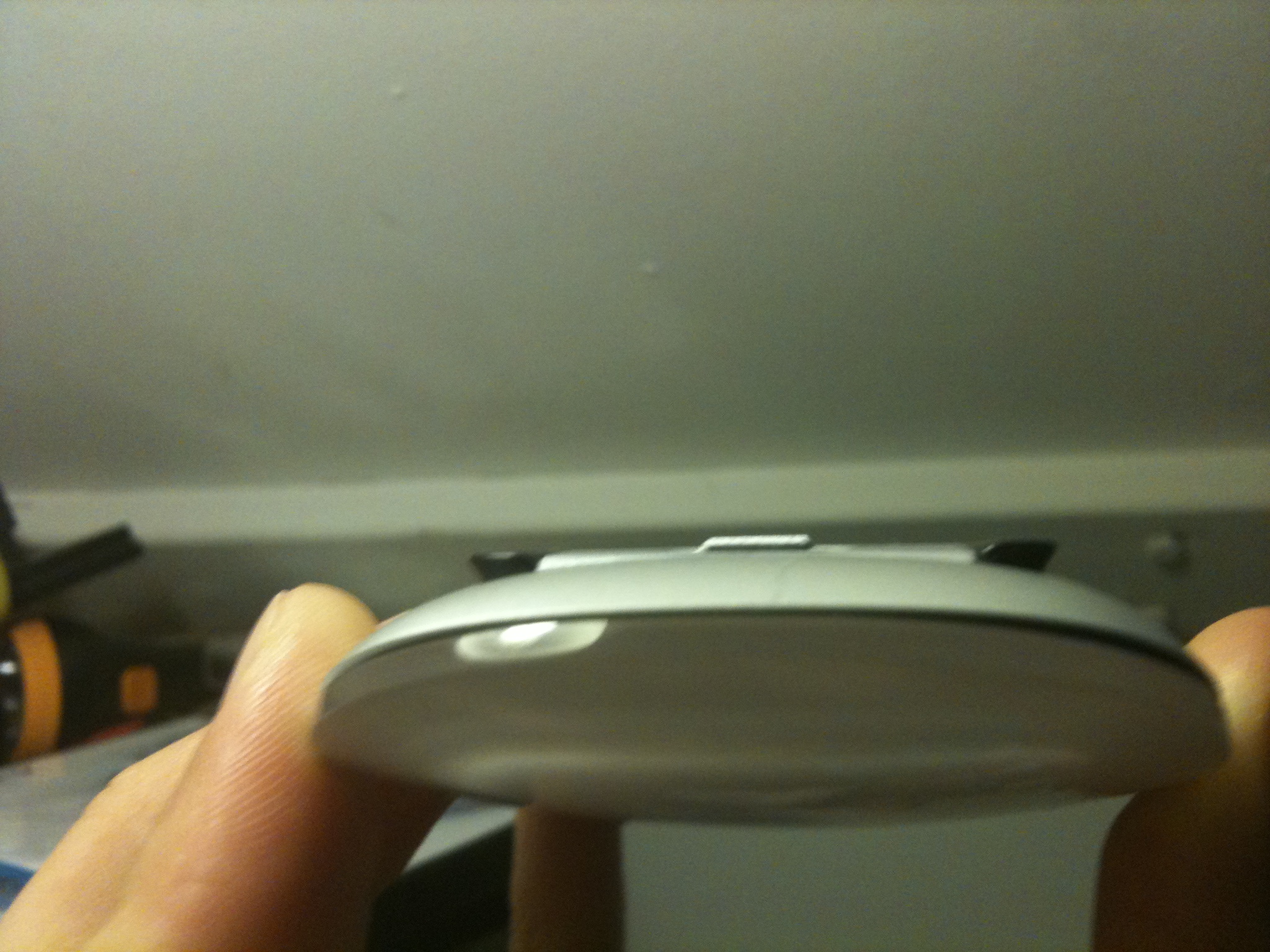

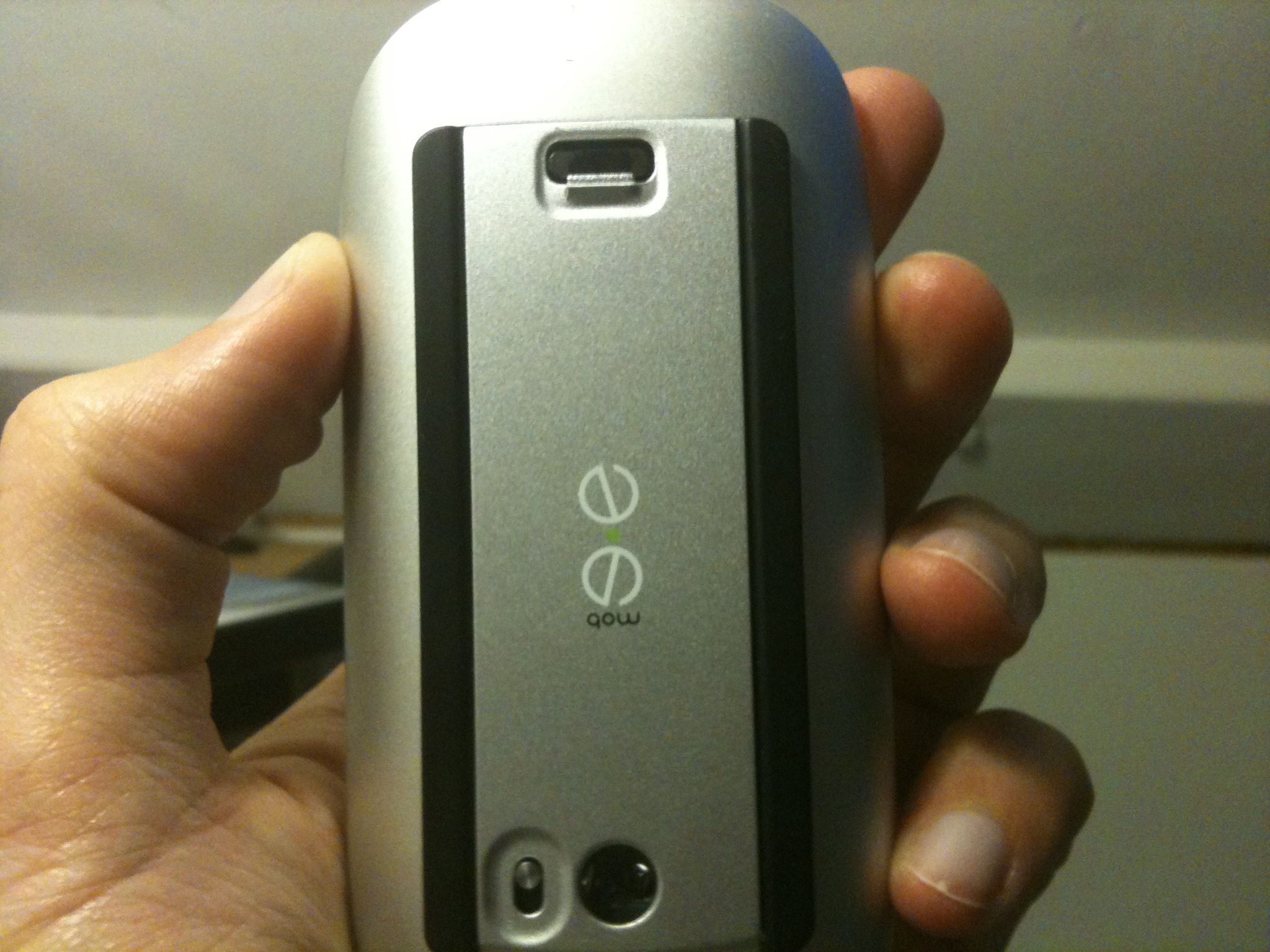

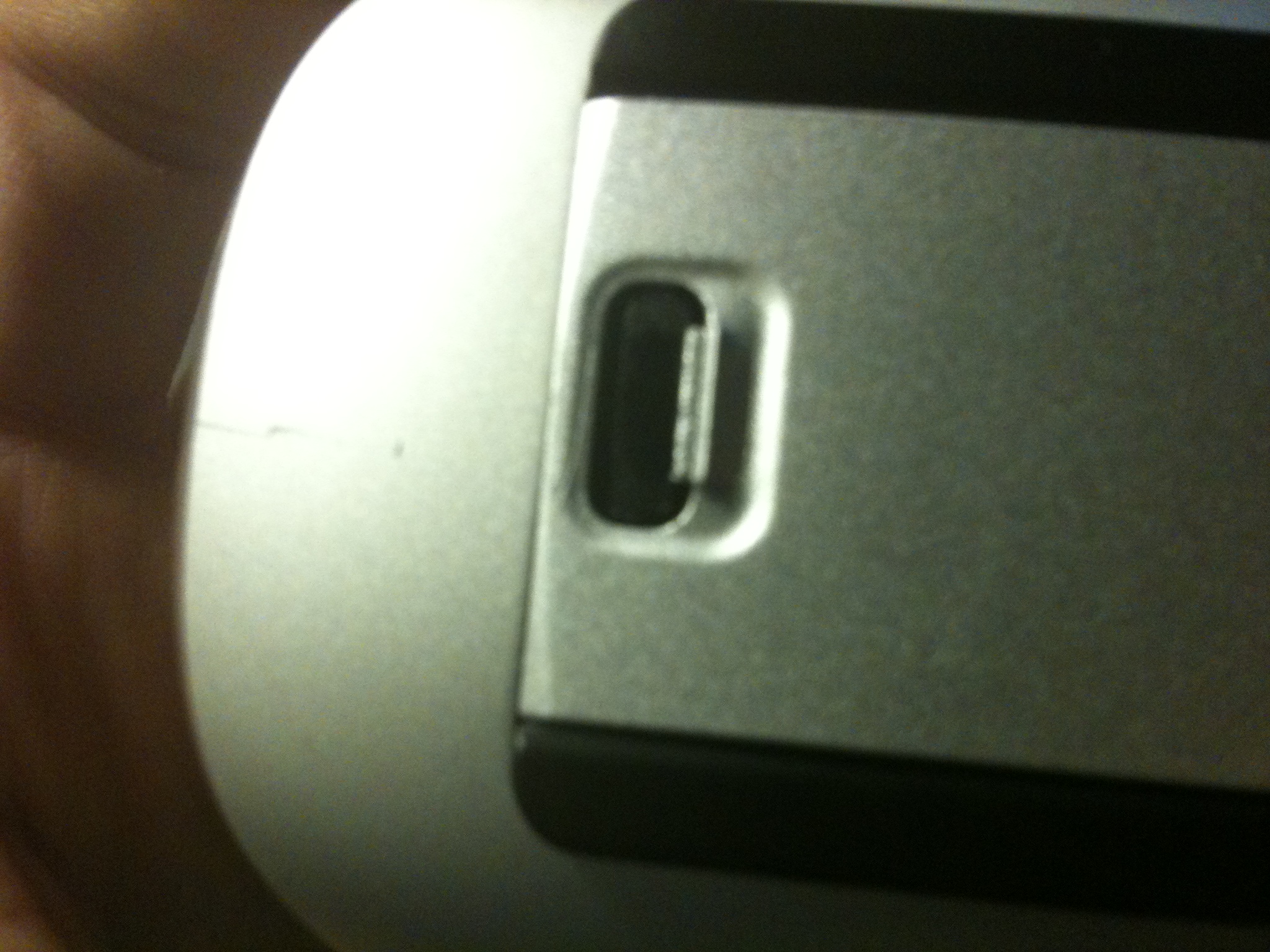

My battery pack is fitting, but I do have the problem of that tiny part sticking out beyond the skids. Applying force does not help here, the battery pack won't go in any further.
I have attached some pictures to show what I mean.
After comparing it to some video's on youtube it seems to me that somehow that part only sticks out on my battery pack. Others do not have that, which makes those fit better. And yes it also looks like that should I take the battery pack out.

I have been offered a replacement. My question to someone who has this exact same charger, will this make a difference?
Since I do not know if I will experience the same problem. I looked at several video's which don't have that tiny part sticking out. So I'm not sure if I just have a faulty unit, but it seems likely though.
Got a replacement. It appears the cover was faulty. This one fits perfectly and doesn't scratch any surface or sticks out.
Battery Cover Tab
I just received my new Mobee Mouse battery pack and it has the same problem as noted here. The latch (tab) at the bottom of the battery pack, basically went the "wrong way", the battery pack as a result was slightly ajar at the bottom, and that tab was scratching my mousepad. After fiddling with it, I just took off the tab and the battery pack is staying in place anyway. So for now, if it stays in place, I'm content. FYi/Yez
