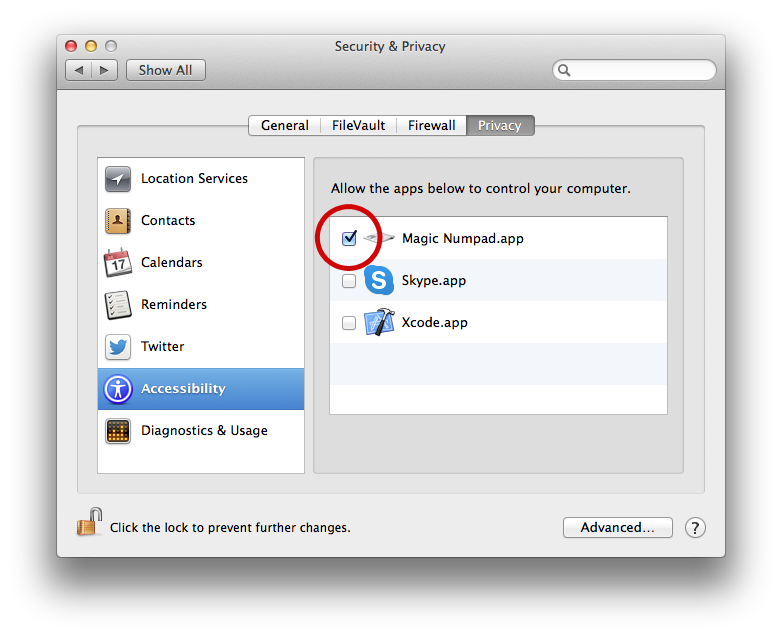

After maverick, nothing is working, Sent an e-mail to Mobee customer support and they sent a special update V2.2 via this link http://www.sendspace.com/file/ruhbt8 and asked me to "To enable the keyboard shortcut under Mavericks go to System Preferences > Security & Privacy > Accessibility and check support for Magic Numpad.app as attached picture"
After that It worked as usual with the F6 Button, Just wanted to write the solution in case someone searched the internet for a solution.
