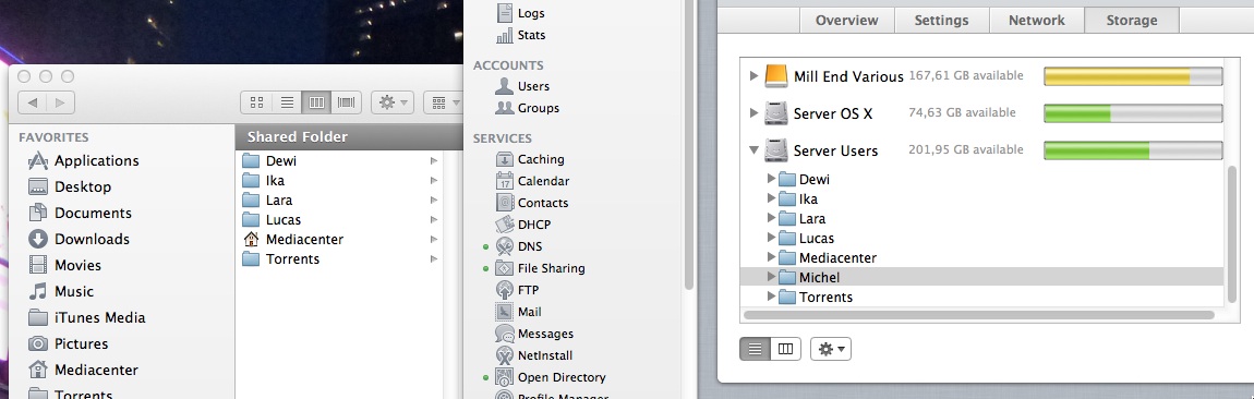

When log in on my server as admin then on the server my Home Folder (my user account) is gone or at least invisible. For the other users the home folders are still there and accessible.
If I try to make a new folder with the same (user) name OS X gives me the error that the folder already exists (although it is not visible).
When I open the Server App and look under File Sharing then my Home Folder is visible however it won't let me change permissions.

John, thanks. Am no expert at this. In Server App I can reset and edit permissions for all users except my own account: there's no OK button....
I tried CHOWN but having trouble to formulate it.
Basically I have 1 hard drive with OSX and Apps and Admin Account and 1 hard drive (Server Users) with all the user accounts.
How do I formulate this into terminal? SUDO CHOWN -R Michel /Michel???

I *think* you'll want to do the following on the server:
cd /Volumes/Server\ Users
sudo chown -R michel:staff Michel
sudo chflags -nohidden Michel
The cd makes the Server Users volume your current directory ("/" always refers to the drive OS X is running on; other drives are presented as directories under Volumes in the root of the system drive). Then chown with the -R flag to apply to subfolders, michel:staff makes you the owner with staff as the group, and the final Michel refers to your home folder. Then the chflags command to make sure it isn't set to be hidden.
Once that's done, you can check the permissions (and compare them to other home folders) by running:
ls -l
*Hopefully* this will set things straight...
Dear John,
It worked!!!! Thanks so much.
I had to fiddle a bit with the sudo commands as it did not recognize my Michel folder. But with your cd example I got it working (sudo chown -R michel:staff /Volumes/Server\ Users/Michel) and same for chflags.
