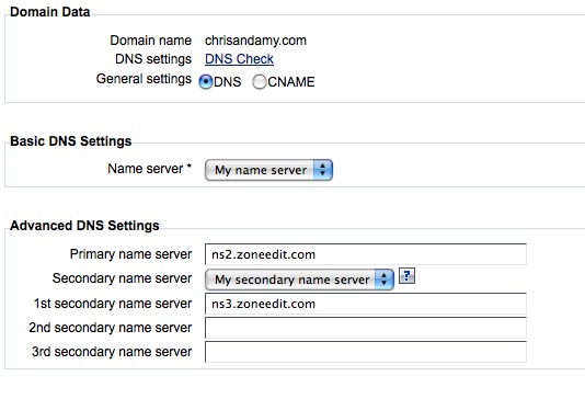

What you need to do is go to 1&1's admin page and and change the DNS servers to the ones that ZoneEdit gave you. Picture 1 a screenshot of what it should look like on 1&1.

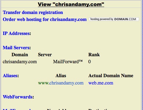

Next, go to ZoneEdit and set up the alias. Picture 2 shows the Alias screen on ZoneEdit. Under Alias, type www and under actual name, type web.me.com then click on add new alias.

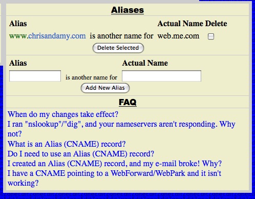

Picture 3 shows what the overview looks like.

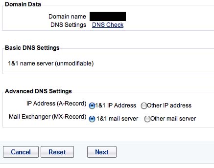

I think I've done something wrong....
Mine says 'unmodifiable'.
Hmmm.
It's possible that if you just registered the domain name they will not allow you to change the DNS right away. They may make you wait 30 days.
In the meantime, you could simply forward your domain to your MobileMe site.
Select the domain name in the 1&1 Control Panel, and click the "Destination" button. On the next page, under "Destination", click on "Edit".
For "Select Destination Type", select "Forward your Domain". Under Destination, type in the web address of your MobileMe site. For forwarding type use HTTP Redirect.
That will allow you (for now) to simply forward traffic to your site. If you still wish to use a CNAME, you can easily add the ZoneEdit info later on.
