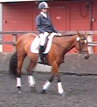

The playback on the camcorder and through a TV is excellent. However, you can see on this screenshot the quality when seen on my Mac. Note the horse's legs. This is only evident in shots with appreciable movement, either of the subject, or the camera.

It is because the video is interlaced, btw, MPEG-4 is not meant for editing, better use the DV codec.
Interlaced footage does show such stripes when being played back on a non-interlacing monitor, a TV and the camcorder surely are being capable to play interlaced footage without problems.
