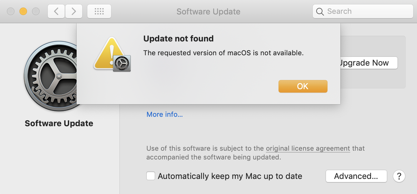

so i do my normally google for the apple link to get os high sierra, it takes me to the MAS, great! i click "Get"... im running mac os 10.4.6 on this macbook, so it takes me to "software update" in system preferences, where it proceedes to give me this error
471cee44-da5f-48f1-bd7d-f0e67139a6ed
it should be noted aftter some research, i found this workaround WORKED FINE before the release of os catalina. now the catalina has been released this feature is not possible.

heres the error that didnt show up in the post
Try going to dosdude1.com select My Software and then look for the MAC OS High Sierra Patcher. Run the patcher only to download a copy of High Sierra Installer package which it does from Apple servers. Don’t patch the installer just run the downloaded installer as you would normally do. You can also download Sierra this way from his patcher.
I think you have the High Sierra installer file somewhere on your Mac Pro, and that's why that link won't let you go to the High Sierra Install page. That happened to me, and I found it hiding in plain sight somewhere.
Search your Applications folder and the entire disk for that install file, delete it, then go to the install High Sierra link.
Just to be sure, you can remove all other disks attached to the Mac Pro, so you only have one disk to look through.
Also, I had issues that were solved by booting and holding Command+Option+P+R for three full 'bonnnnng' cycles to wipe my NVRAM. Maybe do that, too. The link to High Sierra does still work.
I think the issue is 10.4 didn't have the App Store, I think that was 10.6 (Snow Leopard) if I'm not mistaken.
You mentioned you were able to download Sierra dmg, what if you install Sierra on to the Mac Pro so you have access to the App Store and can do one of these options:
  1. Upgrade from Sierra to High Sierra
  2. If you prefer a fresh install of High Sierra and have a USB drive do a createinstallmedia
I just had the issue wonderspark was talking about trying to get a new enough version of High Sierra and Mojave for the firmware upgrades so I know the download links worked in the App Store a few hours ago. The requirements there being you don't have a copy the App Store can find and have the App Store.
