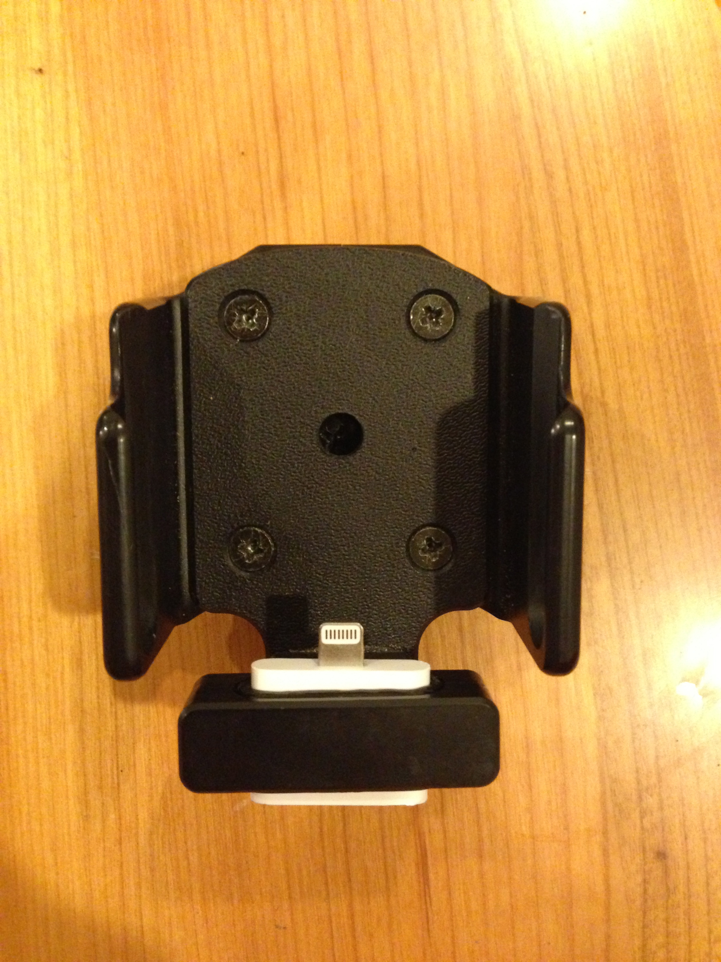

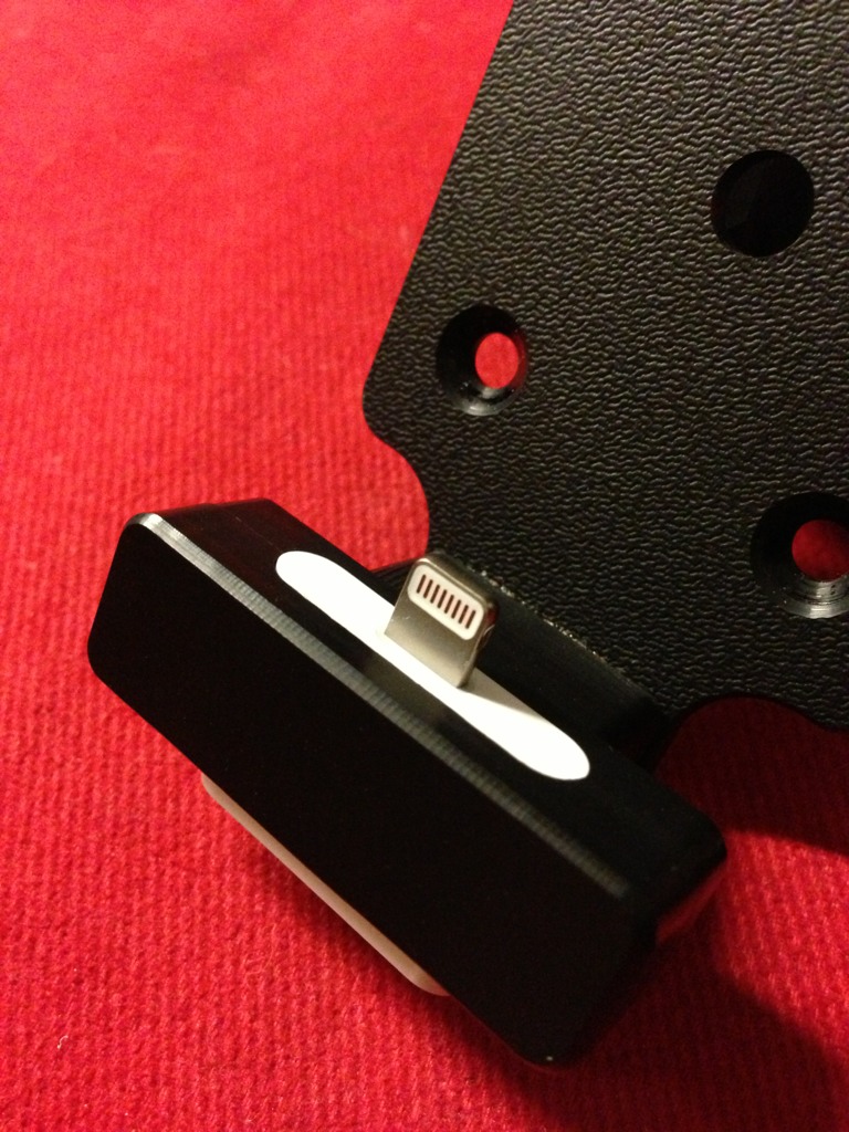

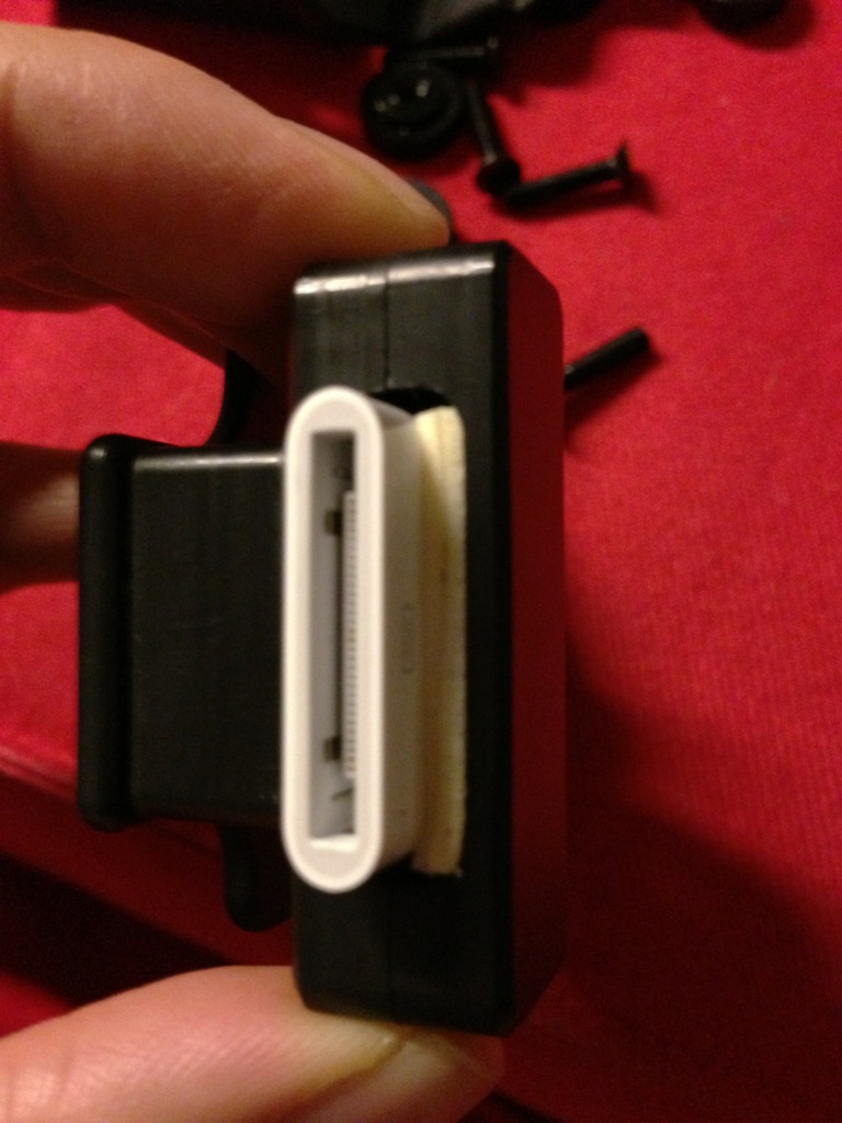

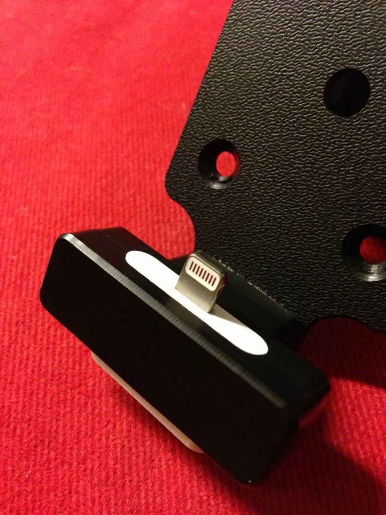

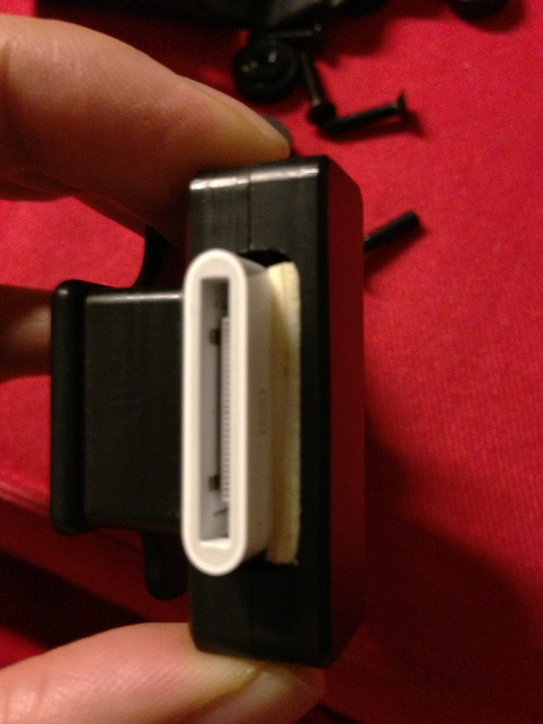

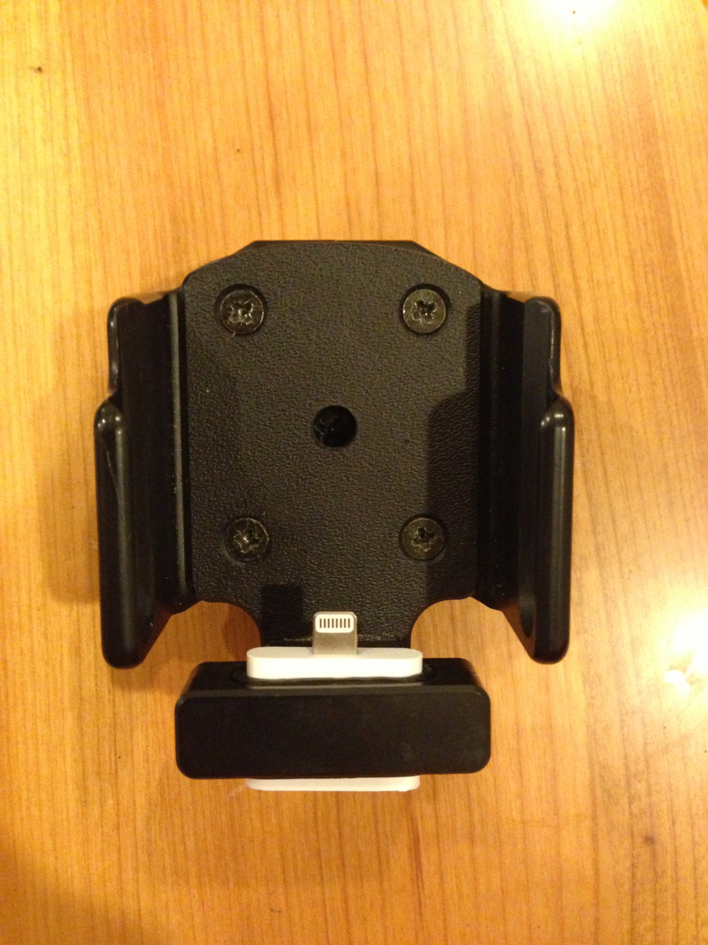

Does anyone know who posted a picture of their proclip iphone 4 passthrough connector modded for the lightening 30 pin adapter? The thread which it was in "The best iPhone 5 car mounting solution?" seems to have disappeared
It was easier then I thought. Just 2 screws to take out the 30 pin adapter. Replaced it with the lightening adapter and used 3m mounting foam squares cut to size.
I thought about sanding down the holder pieces and enlarging the screw holes so I can get a narrower width for a caseless iPhone 5 but will try it as is for now. I used a caseless 4/4s on the proclip for over a year with no problems. The grooves didn't provide any stabilization that way, purely as "guides" for docking the phone.
ImageUploadedByTapatalk1351314426.771445.jpgImageUploadedByTapatalk1351314436.804210.jpg
I did the same as you, but I left the sides on so I could line up the phone and adapter for easy insertion. The Proclip I had for a 4 with a case when completely closed was too loose for the 5. I therefore put some adhesive backed felt on the side holders and that was perfect. Also protects the finish.
With the adapter in the phone and the bottom pieces separated, I then slid it into place to find the best position and alignment.
What I used to fill the gap around the adapter is a stretchy black tape that is used to seal pipes. I don't know what the exact name is, but when you stretch it and wrap it on itself, it seals to itself and is slightly compressible so it holds the adapter in place quite nicely.
Since the lightning adapter "snaps" into place and requires a bit of a pull to remove the phone, be careful. I usually put counter pressure on the Proclip as I remove the phone.

I used a caseless iphone 4 and 4S in the adjustable proclip so it was always too wide. My thought process back then was to cover my bases just in case I got a case or for future wider iphones (0/2).
Anyway, the 30pin plug is more stable than the lightening plug so after using my modded mount this weekend I realize that the phone isn't as secure (bounces back on screen taps). I did try adhesive backed felt also but it was a little too thick and I lost the grooves that made it easier to guide the phone in. I think I may add some kind of foam or rubber piece on the face of the mount so the phone sort of has back support. Just has to be the right thickness.
Sugru!
I had the same problem, and like you, tired rubber feet and felt, all of which eventually came off leaving a sticky residue.
I took a hunk of black Sugru and molded it into a blunt cone shape. I put it on the Proclip right behind the phone. I then put the phone in the holder so that the Sugru was a backrest for the phone. Works great.

Was your passthrough adapter not glued to the mount? Even after unscrewing the 2 screws, I can't remove mine from the mount.
I know this might not solve the problem ideally, but I took my iphone 4 with case proclip and just tore off the cable-passthrough part. Now, the 5 can sit in the same proclip in a case and I just feed the lightning cable into it after I put it in the dock.
Yeah, if i can't get the passthrough connector out, that's what i'm doing. I'll just dremel the whole section off.
Here's how mine looks:
The reason it doesn't sit flush is because the sides do actually hold the naked iphone suspended so the adaptor had to be raised to dock properly.
