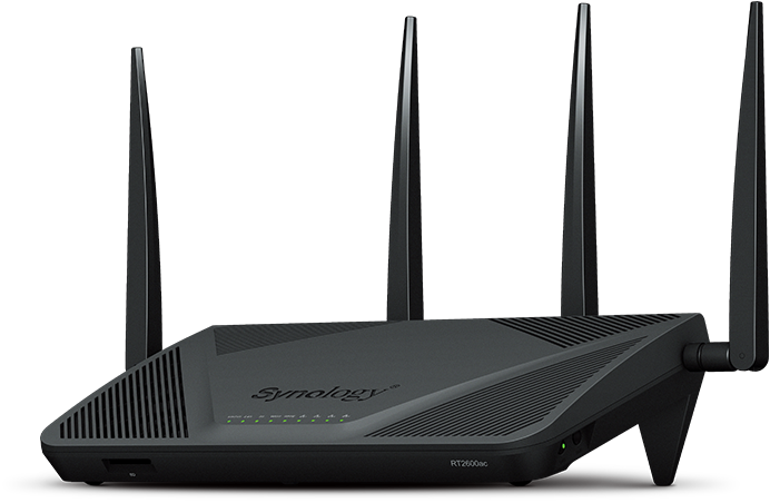

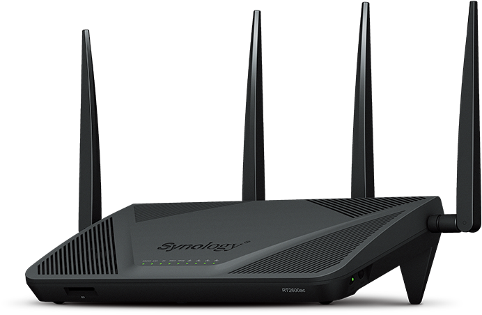

This router is solid and has the best web app for management:
Synology Router RT2600ac
My house is only 2300 SQ FT and we get excellent coverage throughout. If you need more Synology enables a mesh option with the MR2200AC.
Also, integrates with Synology NAS.
I use this. Like it a lot, excellent network performance, but has a lot of options that can get people into trouble (although the web interface is really nice). Also has some features that don't quite work as intended... I hesitate to recommend this router to people largely because Synology is likely either on the verge of upgrading it or abandoning it.
I recently purchased a Synology NAS as well, and I don't see any integration between the two. In fact, if you wanted to have your NAS be internet-facing, they don't even list their own router in the NAS configuration for allowing the NAS and the router to interface directly. What integration have you noted?
