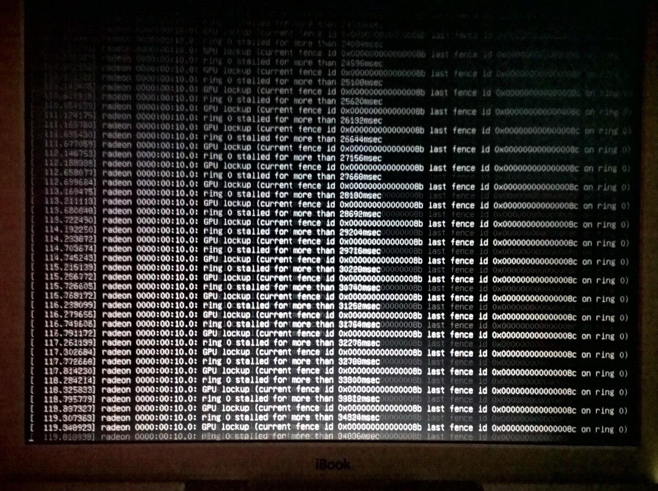

After almost a year of testing and tinkering, I have finally identified the problem that made running a modern version of Xorg impossible on an iBook G3 Dual USB. The problem, as described in this post I made with my old account, appeared after the transition from UMS to KMS in the Linux -and OpenBSD- kernel. You can find the solution at the bottom of this post. But now, let's see how I found it, out of sheer luck.
After starting Xorg, the screen started to flicker and the system froze, leaving the user unable to switch to another tty or do anything at all without a hard reset. If you were lucky, after this happened, you could see the kernel spitting out dozens of errors on your screen:
However, something made me think. Sometimes, the screen did not start to flicker until you tried to drag a window or moved the cursor very quickly. After trying some "fixes" with various degrees of success, like compiling an old kernel with UMS support and "reverse backporting" the UMS drivers from an older Debian version, or just disabling hardware acceleration altogether, I decided to take a look at the radeon(4) man page. And I found this:

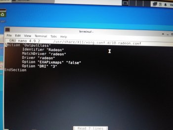

The fix
It's actually very easy. Just create a file under /usr/share/X11/xorg.conf.d called "10-radeon.conf" (or edit it if it already exists):
Code:
$ sudo nano /usr/share/X11/xorg.conf.d/10-radeon.conf
Make sure it looks like this. The second option enables DRI 3. It should boost performance, and it seems to prevent many crashes present with DRI 2:
Code:
Section "OutputClass"
        Identifier "Radeon"
        MatchDriver "radeon"
        Driver "radeon"
        Option "EXAPixmaps" "false"
        Option "DRI" "3"
EndSection
Run Xorg. It should be working now.

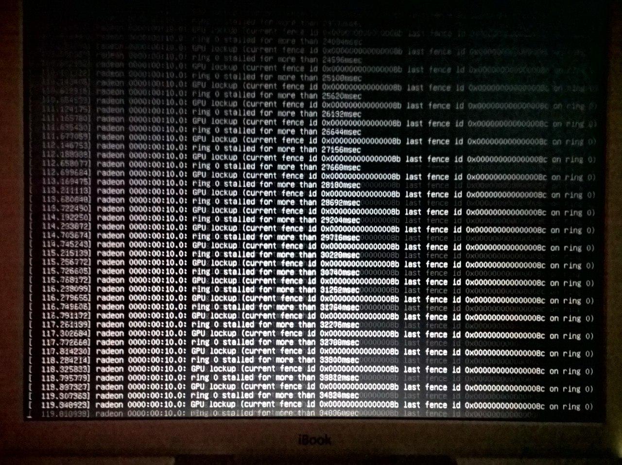

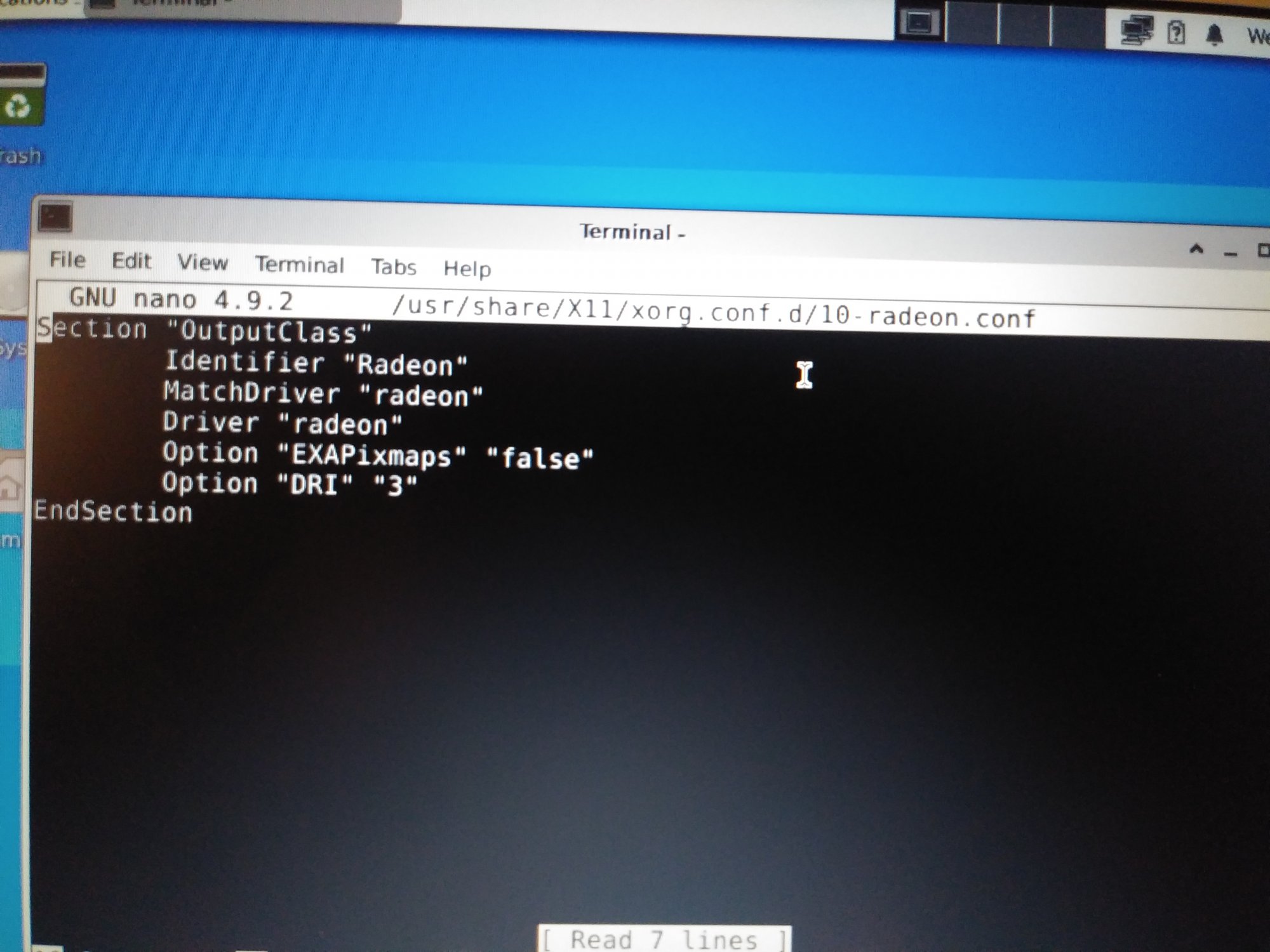

The fix
Code:
Make sure it looks like this:
Code:
        Identifier "Radeon"
        Driver "radeon"
EndSection

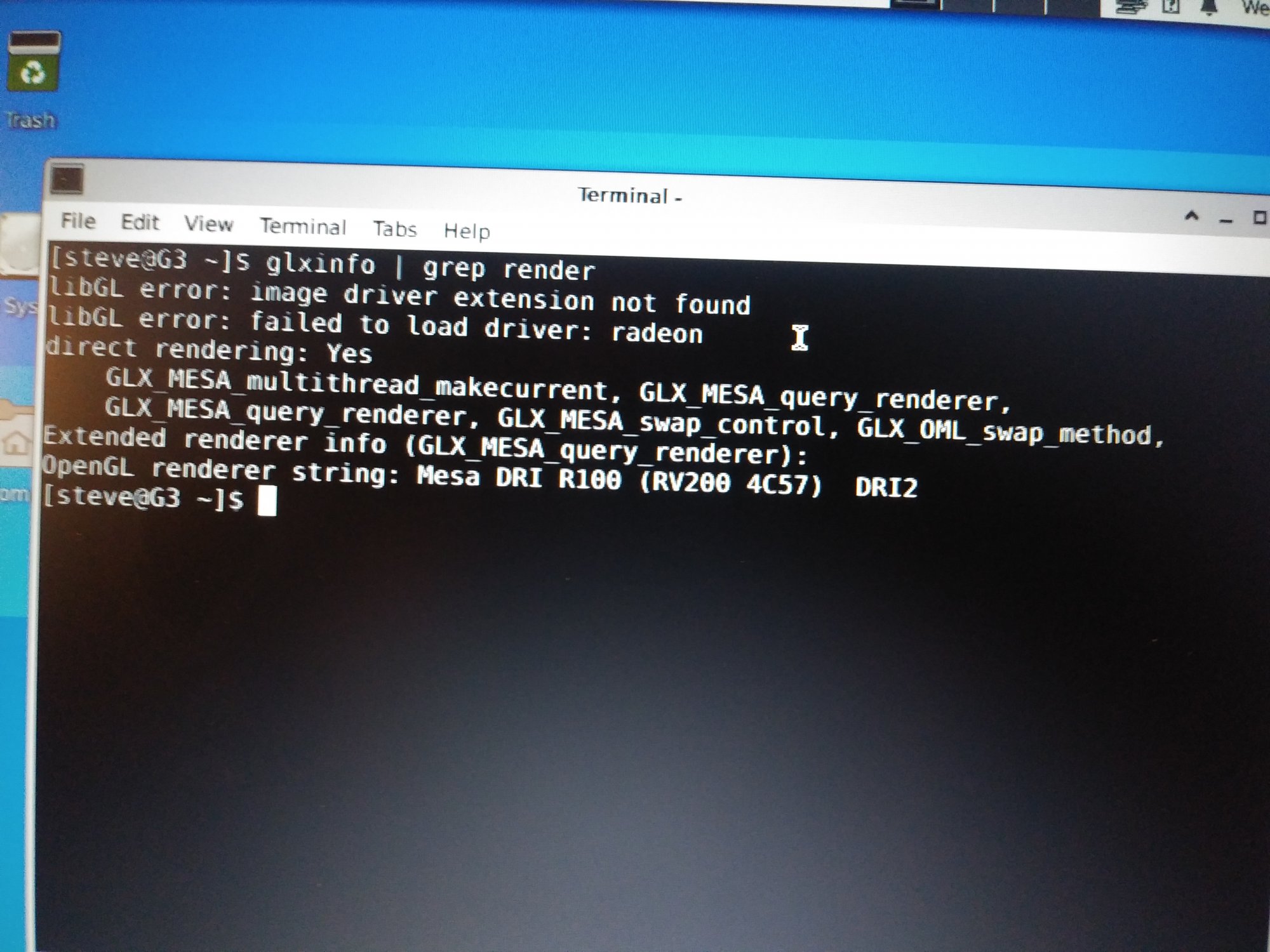

What is the output of glxinfo?
Here’s my xorg conf
Identifier "Radeon"
Driver "radeon"
EndSection
Section “Device”
Identifier “devname”
Driver “radeon”
Option “RenderAccel” “on”
Option “EnablePageFlip” “on”
Option “AccelMethod” “exa”
Option “MigrationHeuristic” “greedy”
Option “ColorTiling” “on”
Option “EXAPixMaps” “off”
Option “SubPixelOrder” “NONE”
Option “DRI” “3”
EndSection
Section “Monitor”
Identifier “Monitor0”
ModelName “TV”
EndSection
Section “Screen”
Identifier “Screen0”
Device “radeon”
Monitor “Monitor0”
SubSection “Display”
ViewPort 0 0
Modes “1360x768”
EndSubSection
EndSection

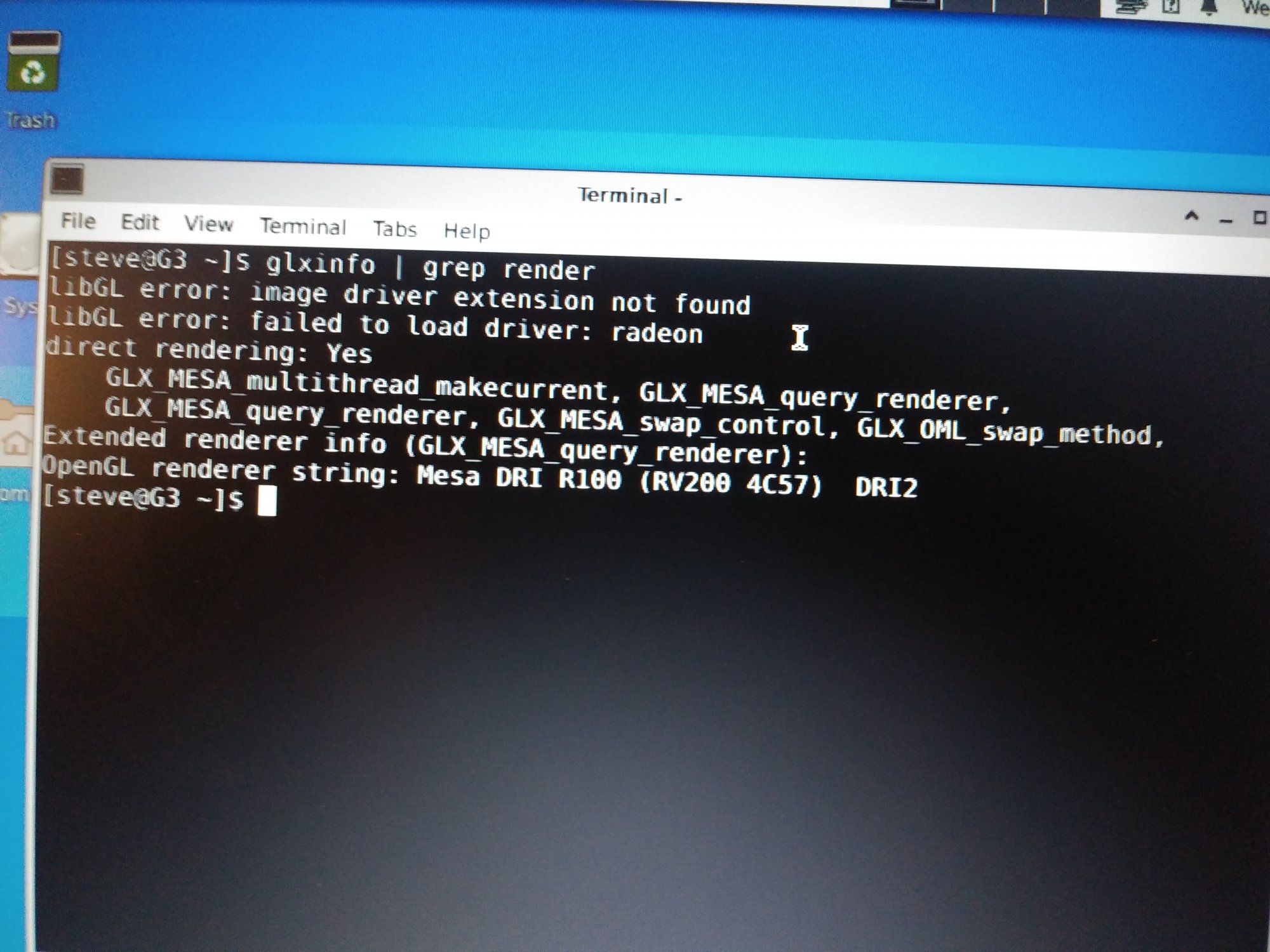

There you go:
Code:
$ glxinfo
name of display: :0.0
display: :0  screen: 0
direct rendering: Yes

Extended renderer info (GLX_MESA_query_renderer):
    Vendor: Mesa Project (0x1002)
    Device: Mesa DRI R100 (RV200 4C57)  DRI2 (0x4c57)
    Version: 20.0.6
    Accelerated: yes
    Video memory: 32MB
    Unified memory: no
    Preferred profile: compat (0x2)
    Max core profile version: 0.0
    Max compat profile version: 1.3
    Max GLES1 profile version: 1.1
    Max GLES[23] profile version: 0.0
OpenGL vendor string: Mesa Project
OpenGL renderer string: Mesa DRI R100 (RV200 4C57)  DRI2
OpenGL version string: 1.3 Mesa 20.0.6

What operating system are you using? After editing 10-radeon.conf I have the locking up problem. I'm using Void, booting the 4.4 kernel.
Reactions: YesWeCat
I'm using Void with the most recent kernel (5.4, I believe). What does your 10-radeon.conf look like?
It looks like our machines are falling back on DRI2. Take a look at your glxinfo, as well as mine.
Reactions: YesWeCat
