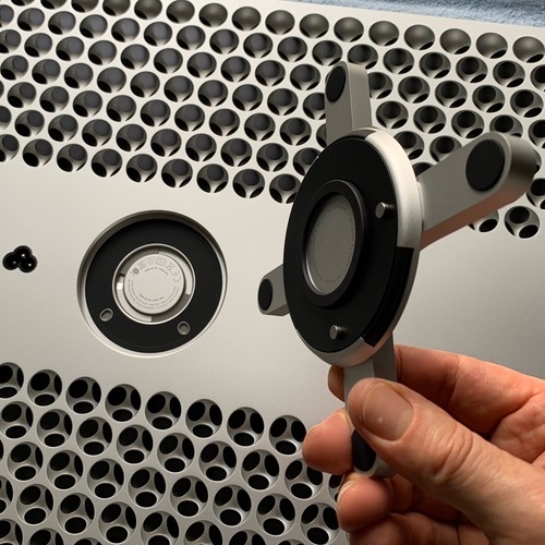

This is the stand fitting:
This is the Apple Vesa mount:
What you need is the X fitting to go on the front side of the stand...
HumanCentric made an XDR Vesa mount that had a X fitting that looks unscrewable, so it might be possible to bolt the X on the front of your XDR stand.
Put four longer mounting bolts further out so they are outside the circular plate on the stand, and make a two-part split semi-circular washer-like metal backplate (with four holes for the bolts) to hold the HumanCentric fitting on the front of your stand.
That's my first thoughts. Possibly...
