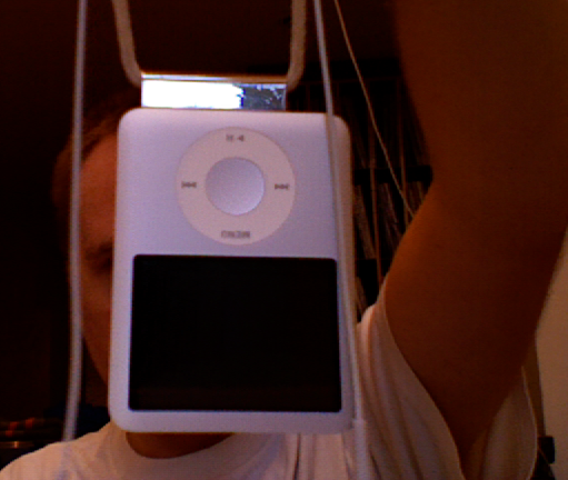

I noted that I still had my old lanyard and that (obviously) it wasn't going to fit.
Sooo I decided to mod my existing one.

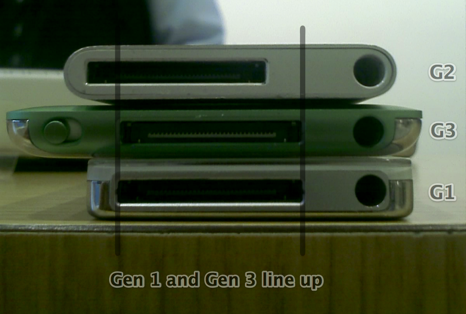

3) Cutting away excess plastic.
Ok so the main problem with the incompatability is that the connector is misaligned, so you will have to cut away at both ends, so that it fits into the new nano - you should see how much needs to be cut by lining up your new nano.
I started cuts with a stanley blade then used a bare small hacksaw blade to cut (one direction only) down and across until the connector is now small enough to fit the new nano.
Take car to clean the left over plastic connector as you do not want stray burrs stopping clean connection and foiling the connector on your new nano.
You could possibly cut the entire connector off because the modification removes the locking ability anyway, but i chose to keep a segment so that my nano is steadied and more stable.
4) Allowing space for the hold button -
You will note that the hold button stops a flush fit, so you will have to file down the end opposite the audio plug with say a nail file (a new clean one with a very fine grade).
With a small amount of filing (not a lot is needed) the device should fit fairly flushly, however it will not be perfect.

Ok, so it should be good to go now, I really can't see how the nano can become detached without you intending it to, but it makes sense not to hurl it around.
The connection will not be as flush and even sided as the fit on the old nano.
But anyway, I think it looks and works fine, now all I need to do is import video content that is flipped so that other people can watch what I am listening to!! 🙂
