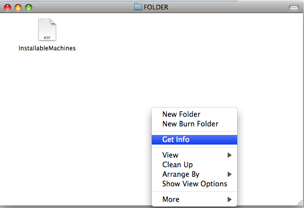

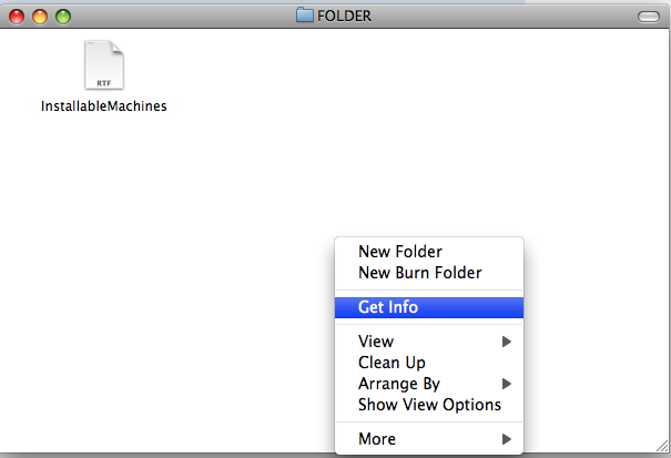

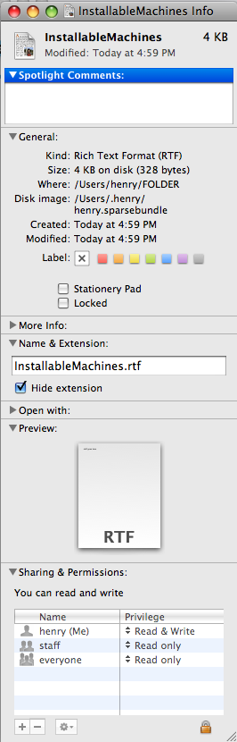

Go into the folder containing InstallableMachines.plist. Right click an empty space in the folder and choose "Get Info".

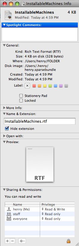

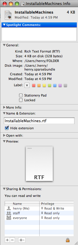

In the get into window, click the lock at the bottom (the lock may be somewhere else in Sierra):
Type your password to unlock the permissions, then give yourself read+write access.

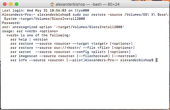

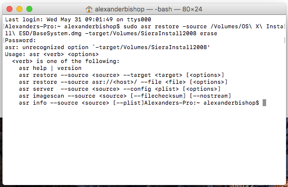

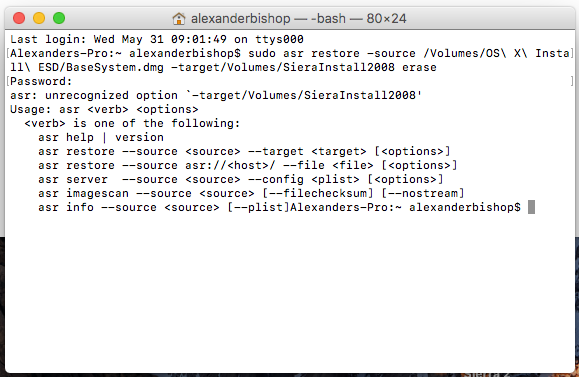

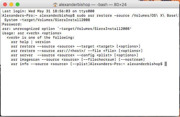

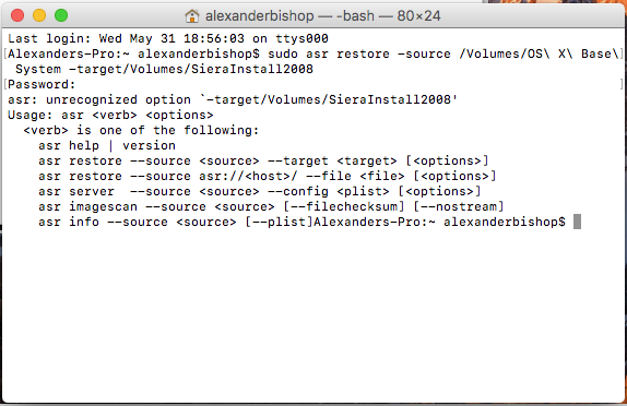

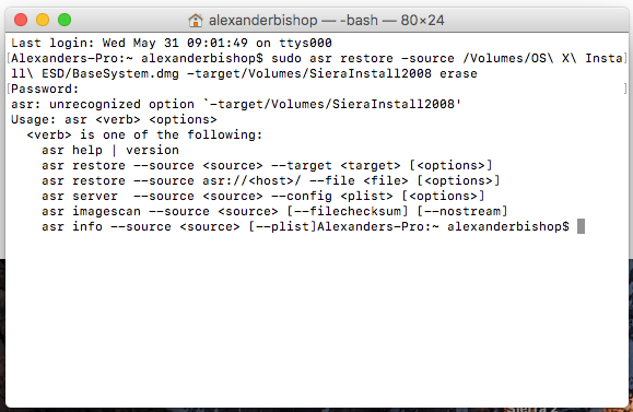

I tried doing what you said, I got the hidden file disk image copied to the desktop. Then I opened terminal and copied/pasted what you wrote, changing /volumes/target to my usb drive, and I got this (first image.) then I changed /volumes/OS\X\Install\ESD/BaseSystem.dmg to the path of the disk image on my computer, and I got the same thing (second image.) So I'm not sure what to do. SierraInstall2008 is my USB drive.
I tried doing what you said, I got the hidden file disk image copied to the desktop. Then I opened terminal and copied/pasted what you wrote, changing /volumes/target to my usb drive, and I got this (first image.) then I changed /volumes/OS\X\Install\ESD/BaseSystem.dmg to the path of the disk image on my computer, and I got the same thing (second image.) So I'm not sure what to do. SierraInstall2008 is my USB drive.View attachment 701729View attachment 701730
You need to put a space between -target and the path.
