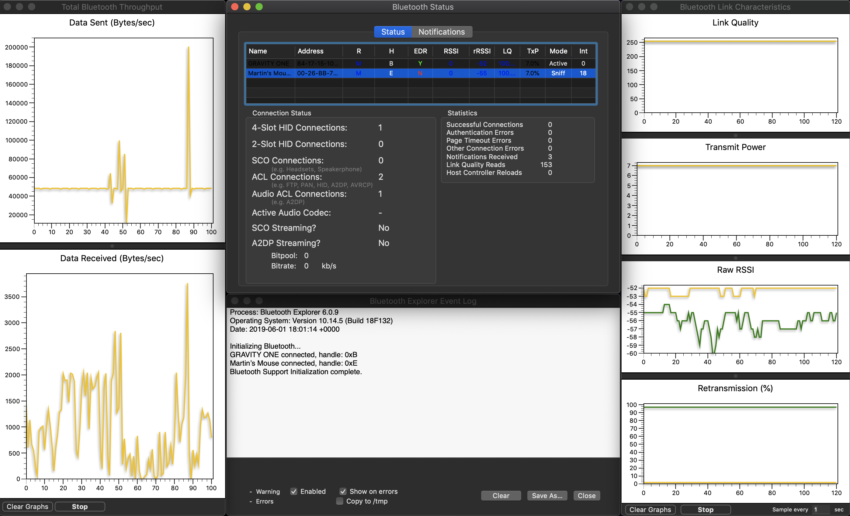

I am also using the original Magic Mouse in Mojave. No issue so far, the Link Quality stay at 100%.
But I have a BT4.2 / Wifi ac card. Not sure if that make any difference.
If feels like interference, the first thing I will try is switch OFF 2.4GHz wifi.

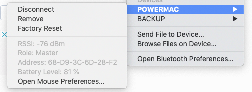

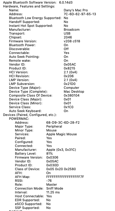

Hi Guys!... I've tried the Antenna upgrade and took care to buy the right one, but my MM1 still with an uncomfortable lag!
Is it with it to change the Bluetooth card? maybe for a BT4.0 for Mac Pro 4/5.1?
If yes, please tell me why you buy!
Or is it better an external dongle BT??
Here's a pic with my bluetooth status!
This is driving me insane!
thanks in advance!

Try point the antenna to a direction that 90 degree offset to the MM (please google how antenna work, the and study where the effective area is).
In general, keep the RSSI at or below -60 will give you flawless experience for MM1, -76 is a bit too low.
Of course if you can place the antenna nearer to the mouse will also help.

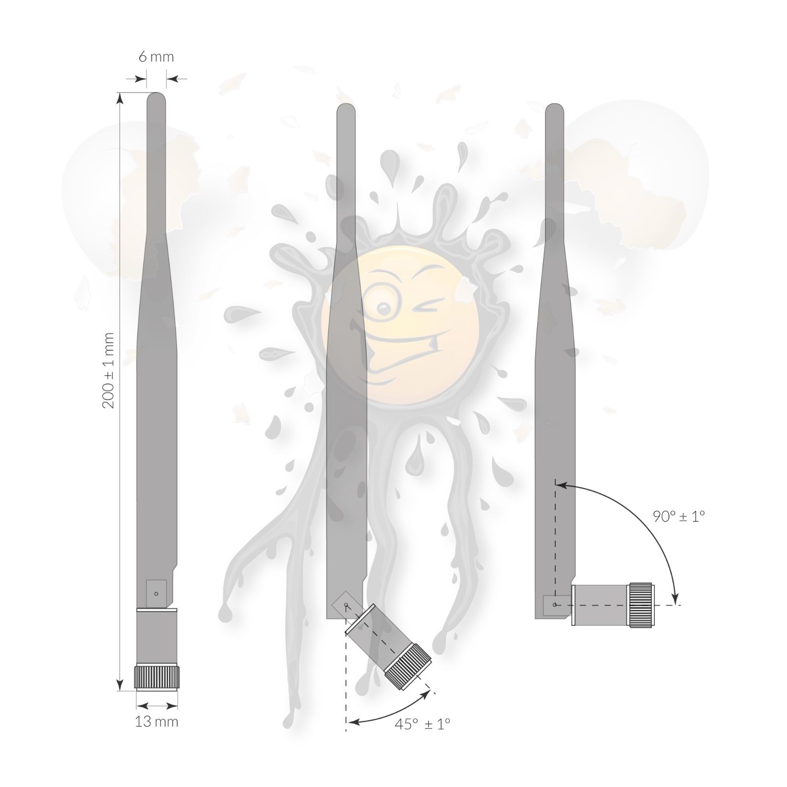

I wonder if mine is the wright Antenna!... please have a look!
Antenna:
WLAN / WIFI 802.11 a/b/g/n 6 dBi Antenne SMA female inkl. I-PEX Adapter
6 DBI ANTENNA FEATURES:
  • Frequency Range 2.4-2.5 GHz
  • Impendance 50 Ω
  • Compact Form Factor 200 mm
  • Non Circularity ± 0.5 dB
  • VSWR < 1.5
  • Return Loss 10 db max
  • Gain Peak up to 6 dBi
  • Radiating Element Material Copper
  • Radome Material EVA
  • Cable Loss 0.3 dBi max
  • Polarization Vertical
  • Maximum Input Power 50W
  • Lightning Protection Direct Ground
  • I-PEX Cable Length 150 ± 5 mm
  • Connector RP SMA female
Cable
  • 100% Brand new and high quality.
  • Connectors: Same as the picture show
  • Type:cable pigtail jumper
  • Connector A: SMA female bulkhead, Gold plating
  • Connector B: IPX U.FL female, Gold plating
  • Cable: 1.13mm
  • Impedance:50Ω
  • Length: 30cm(12in)
Package Included:
1 x SMA Female Bulkhead Jack To IPX U.FL PCI Card 1.13mm cable

Not sure if you have the correct combination. RP SMA female shouldn't able to match SMA female.
Can you identify which two connectors you have according to the above picture?
