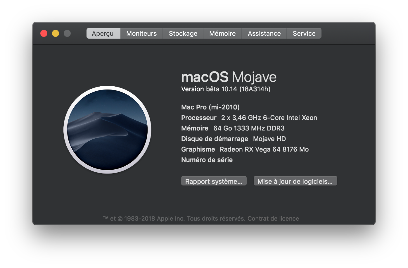

well, the installer let me do it but I didn't have any display after install 🙂
so I tried install from scratch on separate drive.

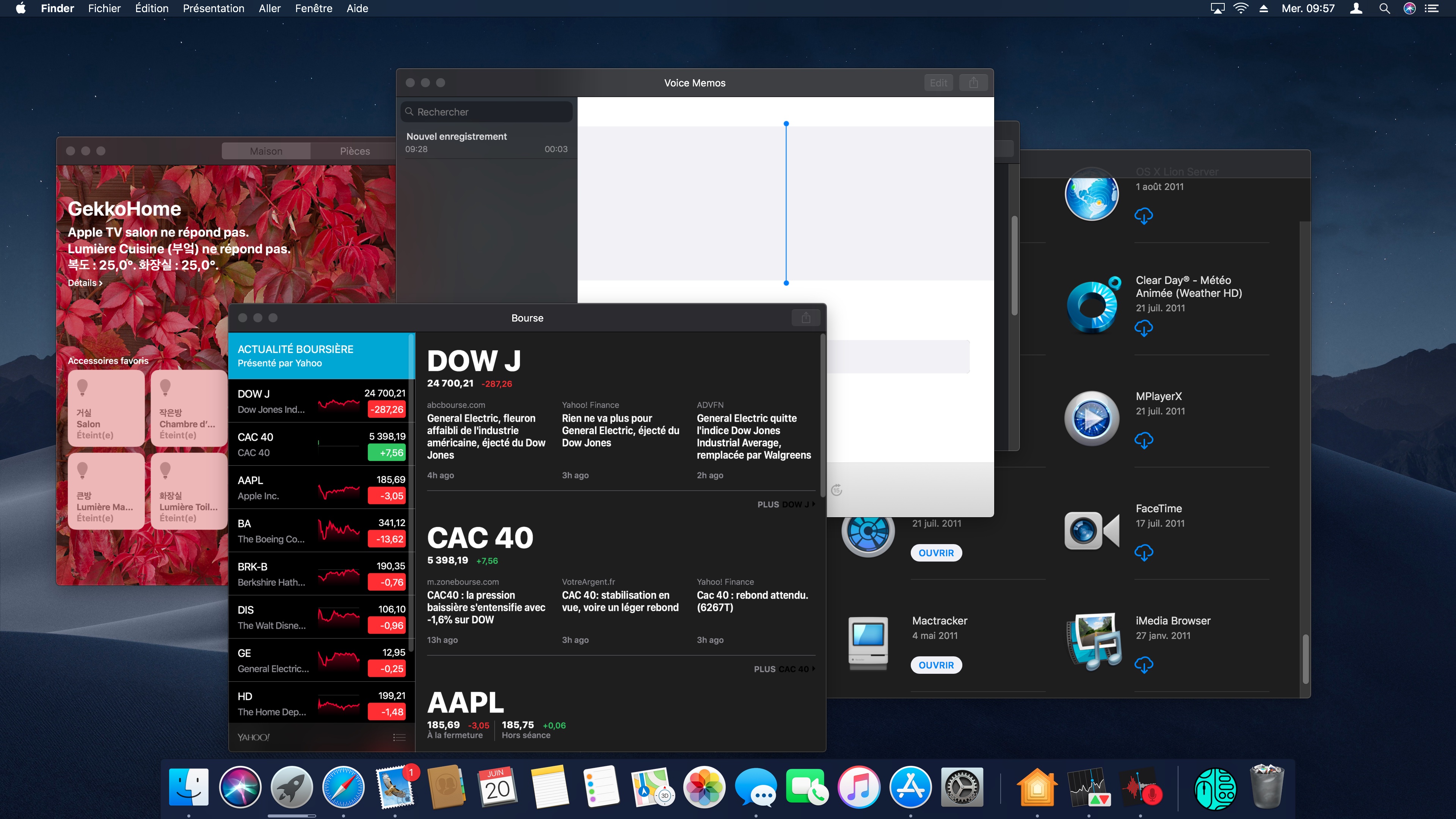

it works well: good news, marzipan apps work on this build!

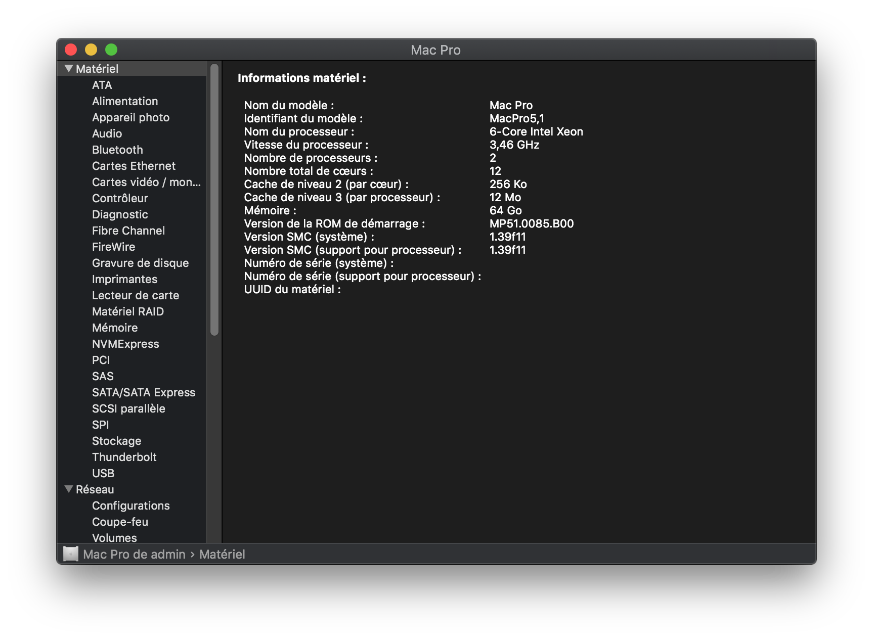

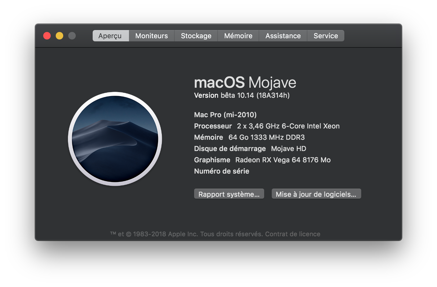

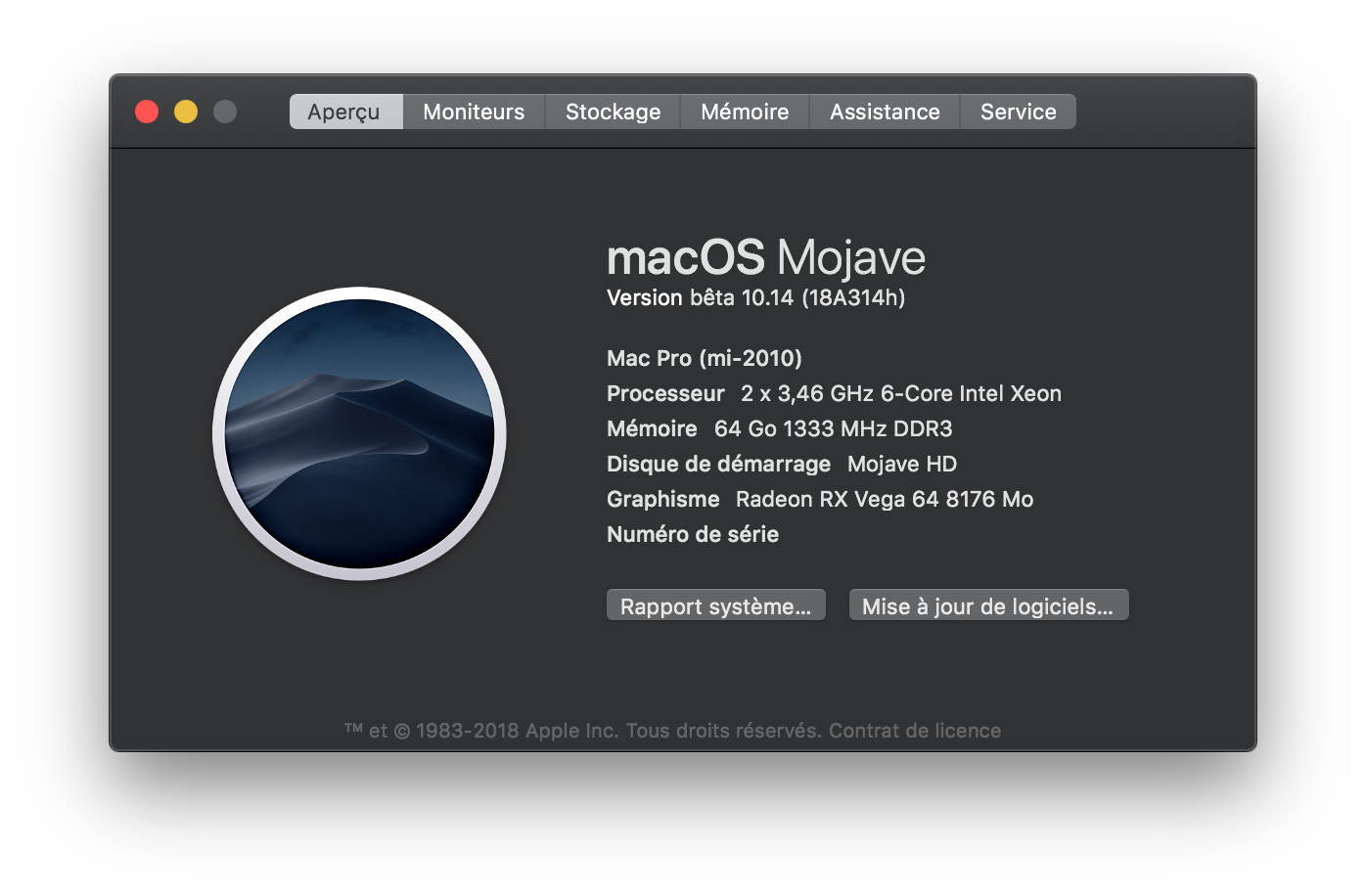

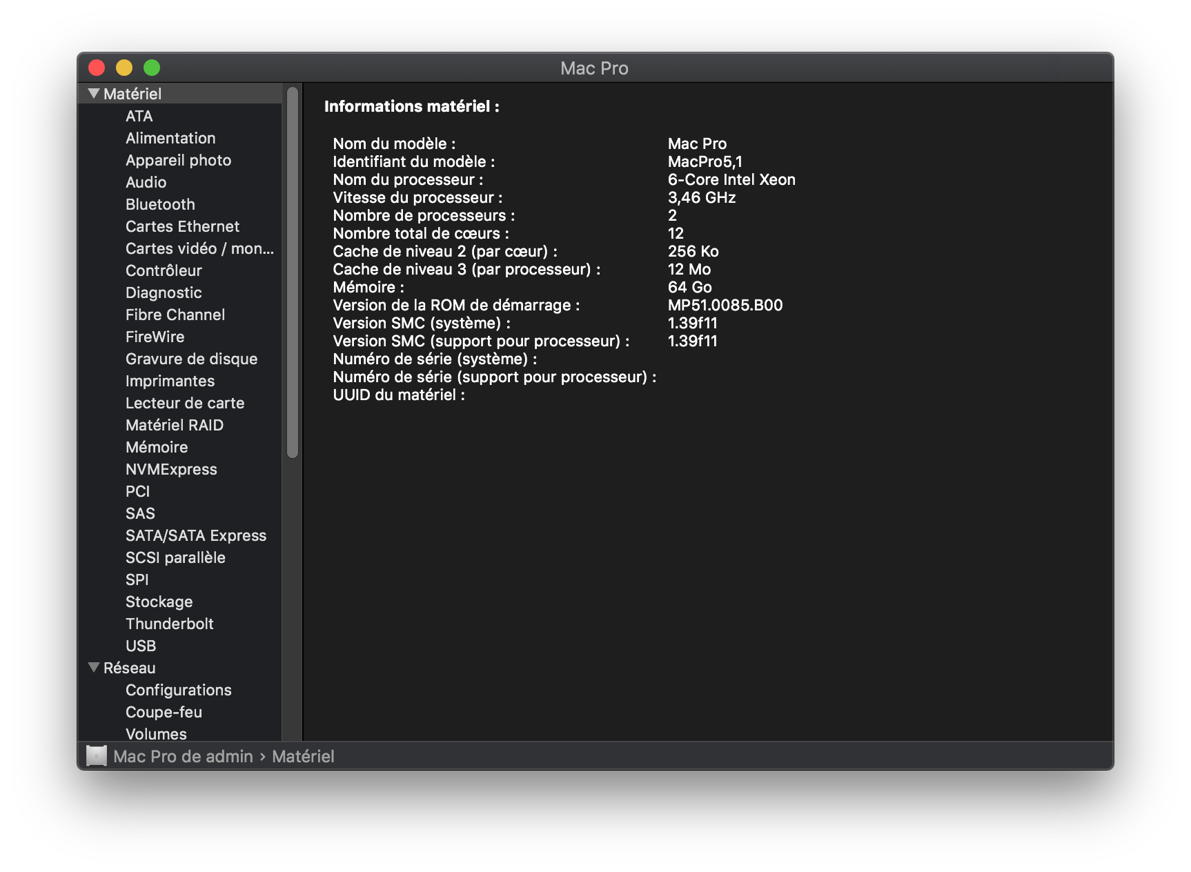

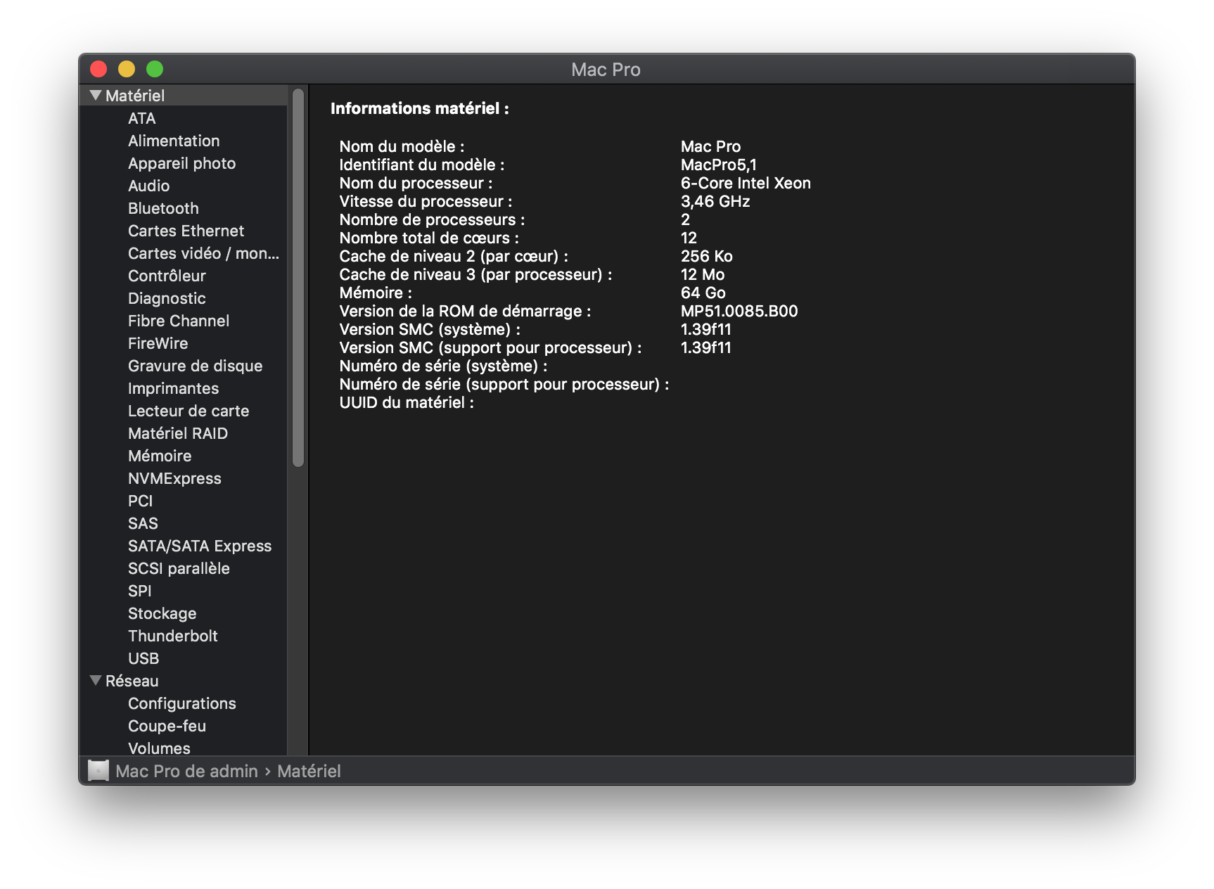

Here are my efi version info and also 5.1 2010. I did the install with only my VEGA 64 (blind boot) no issue.
View attachment 767008 View attachment 767009

Note than the EFI update brought me from Boot ROM Version MP51.0084.B00 -> MP51.0085.B00. Currently running dual Xeon X5690s and the CPU microcode version was at 31 before the upgrade and did not change after the upgrade.
That's pretty interesting. From that it sounds like Apple have removed the 087 firmware in the latest Mojave Beta and replaced it with the older 085, due to the missing microcode in 087 one would presume!
Aha! I recall reading another thread in this forum about missing microcode and was a bit weary to upgrade the EFI firmware. So many numbers moving around I just assumed it was 85, not 87. Time to go catch up on the microcode thread now 🙂
