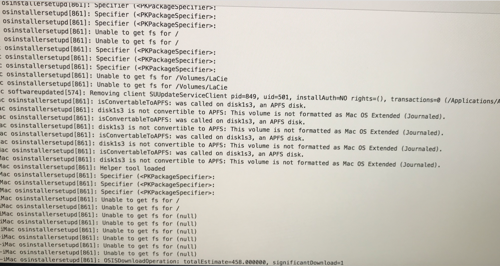

I had a look at the Installer log and have attached a screenshot of what it said. Any help would be greatly appreciated. Thank you.

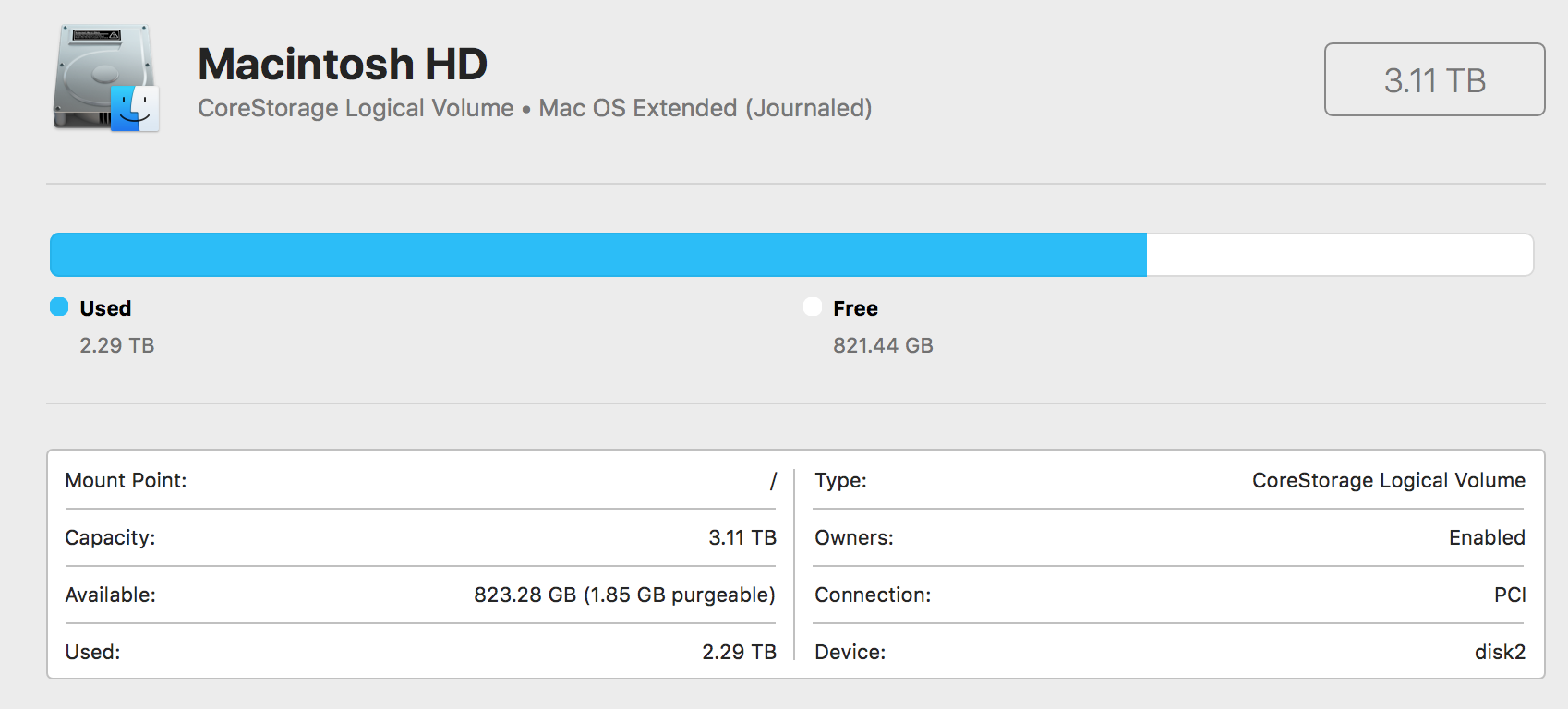

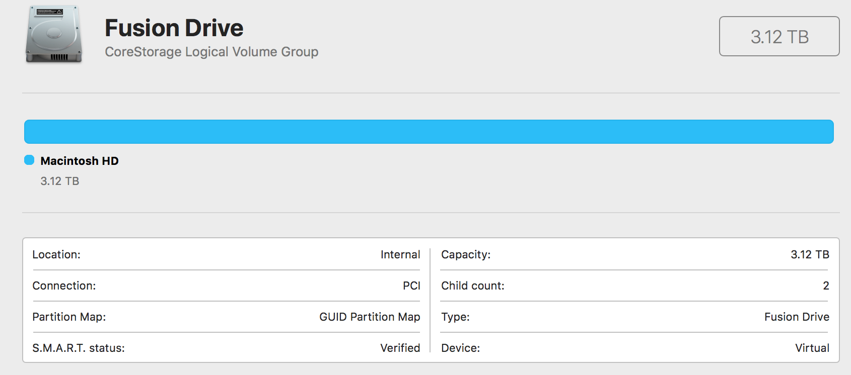

Hi there, thanks for your response. When I look in Disk Utility, the screenshots I have attached to this post are what you can see. Is this how it ought to look?
Edit: The LaCie drive is just storage. Never booted off it, and don't want to.
