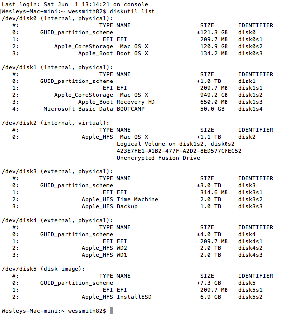

If you can run the Terminal app and type in the following command and post the results here, that would help to understand what your current disk setup is: "diskutil list"

What the information you posted says it that your fusion drive was NOT converted to APFS when you did the Mojave installs.
My recommendation would be that if you don't have a pressing reason to upgrade to Mojave at the moment, stay at High Sierra. When you're ready to invest in a 1TB SSD, you can try it out in an external enclosure and see if Mojave (or Catalina) works there and then you can either keep it as an external or switch it with one of the internal drives if you wish. Because you say that the HDD works fine in High Sierra, this recommendation assumes that there's something going on with Mojave and HFS+ fusion drives and perhaps adding in your data and/or something specific to the 2012 Mini fusion drive configuration.

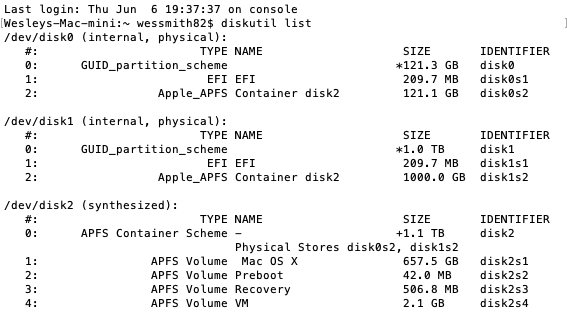

So it worked for me. Removing the Boot camp partition seems to have helped the overall results. Wifi works, no problem at all. Update was quick and everything seems great. Results now for diskutil list below. I just haven't reconnected my external backup drives. I'm just excited the wifi works and it's running like it should. 10.14.5.

So it worked for me. Removing the Boot camp partition seems to have helped the overall results. Wifi works, no problem at all. Update was quick and everything seems great. Results now for diskutil list below. I just haven't reconnected my external backup drives. I'm just excited the wifi works and it's running like it should. 10.14.5. View attachment 841415
Thanks for posting this and reporting your results. As you can probably tell, this time installing Mojave did convert your fusion drive to APFS.
So, based on the work you've done, it looks like Mojave HFS+ fusion drives can cause problems (on the same computer where High Sierra HFS+ fusion drives didn't and Mojave APFS fusion drives, thus far, haven't) and the Boot Camp partition can prevent the conversion of fusion drives from HFS+ to APFS.
Once again, thanks for your posting your results.
