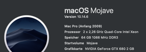

All resolved now ! - I had reinstalled Mojave on a SSD partition...(preformatted as journaled ! not APFS ! because I wanna switch back and forth between 10.9.5. and 10.14.5 for several works I did on both systems) ...total without use of the patcher !! Didn't need it because it's a 5.1 .....all from a install stick with my old 150 - all takes 10 min - put then back my 680 and boot - all fine now - running in 4k (3840x2160) - 40" display in 60 HZ now - over a DP cable 🙂 P.S. Bootrom MP51.0085.B00 from HS - Q: What really "useful" improvement in reg. to "Microcodes" would I have if I used the latest bootrom? -> 140.0.0.0.0 - I saw the list of page on in the forum -but I don't really see for ma a improvement there - exept MvME with the 140.0.0.0.0 with NVMe support ;-)
