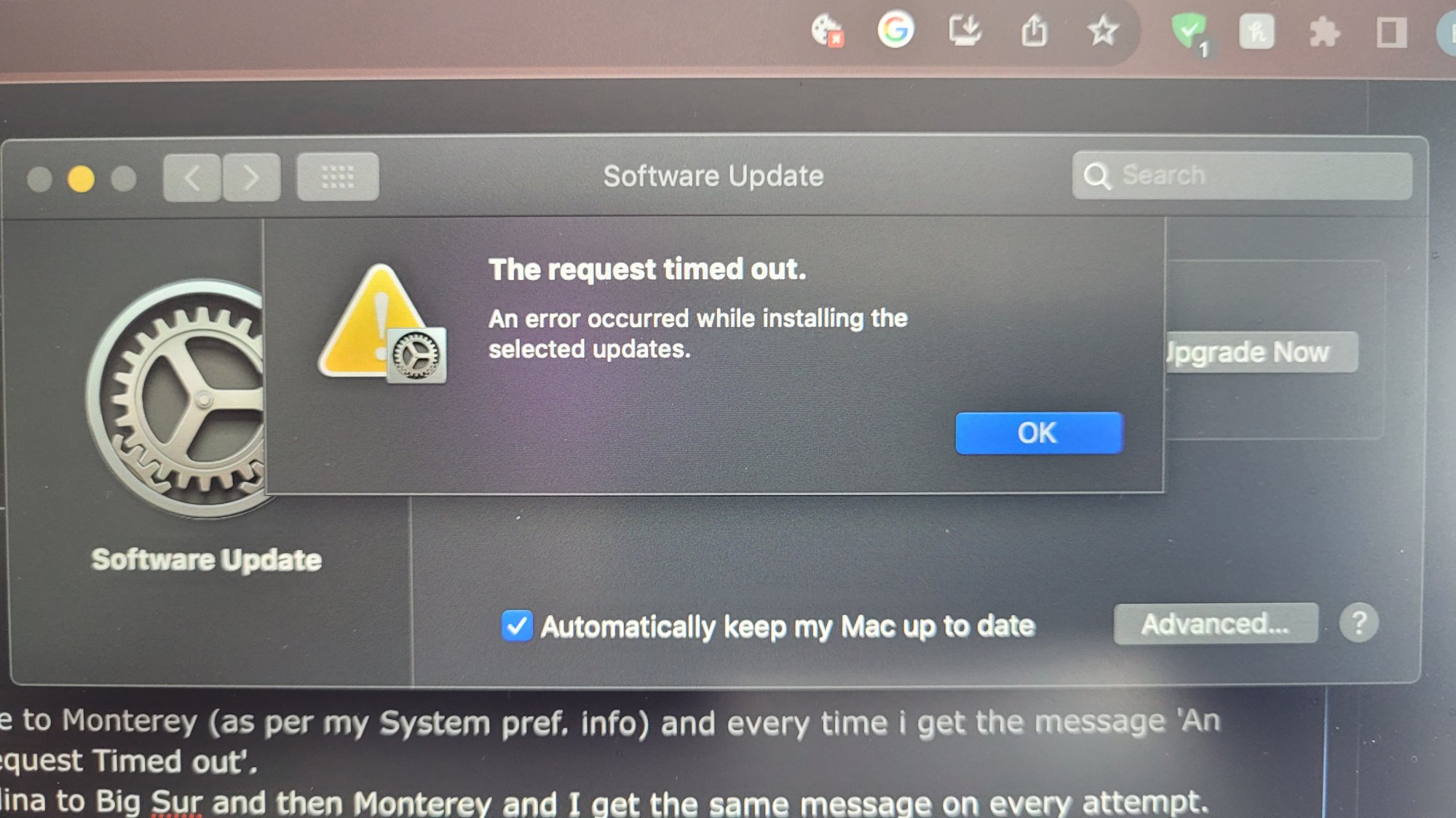

I tried to update my early 2015 MacBook pro from Mojave to Monterey (as per my System pref. info) and every time i get the message 'An error occurred while installing the selected update, the request Timed out'.
I have tried to update progressively from Mojave to Catalina to Big Sur and then Monterey and I get the same message on every attempt.
Now, I have just installed a new 2TB Kingston SSD after using 'Carbon Copy' to clone the old 128Gb drive... the cloning worked fine and the new SSD is rocket speed!
Do you think that the OS updates do not happen because Apple detects a 'non OE' SSD?
If not ...what is the solution?
Thanks

Hi thank you for the info. On my original Apple ssd (128Gb) i only had 6Gb left on it so any update I tried didn't have enough space. As I said, I then cloned my internal Apple SSD using 'CarbonCopy' to an external Kingston 2TB SSD and that worked fine ... I could boot from the external or the internal Apple without any problems. I have now swapped the SSD and again the 2TB is mounted in my Mac and it all works fine.
Before the swap, any updates went straight for the 'Upgrade' and did not offer the choice of just downloading the updates on another drive... and of course I didn't have enough space.
Now with the new SSD installed i get the message that I attached in my first thread.
Ideally I would need a link to a site that is not the "App Store" maybe then it will offer the choice of downloading the updates to another external drive?
BTW the link you mention comes back with: "Access to swcdn.com is denied"
Following on from the above.....
I just happened to look at my Apps folder and found the Monterey Installer icon... so clicked it and now I'm fully updated!
So this last week I replaced the battery pack which was the original from 2015.... upgraded the SSD... cleaned the screen 'bloom' and installed a screen protector that also cuts out glare... I think my Mac has caught up to the 21st century for a very reasonable C$340 or so.
I'm a happy man! :-D
