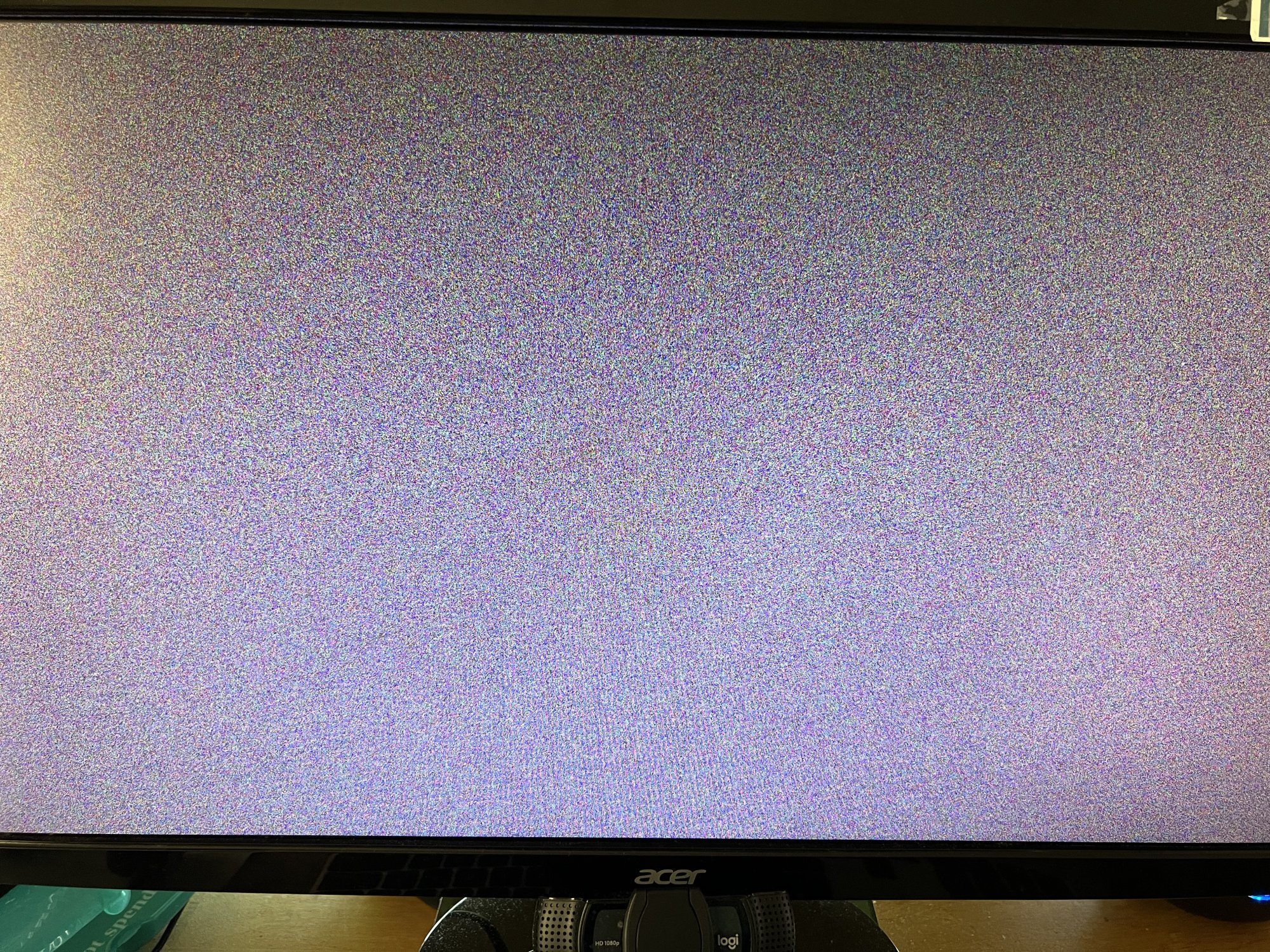

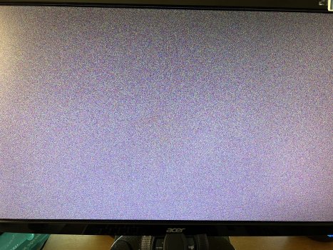

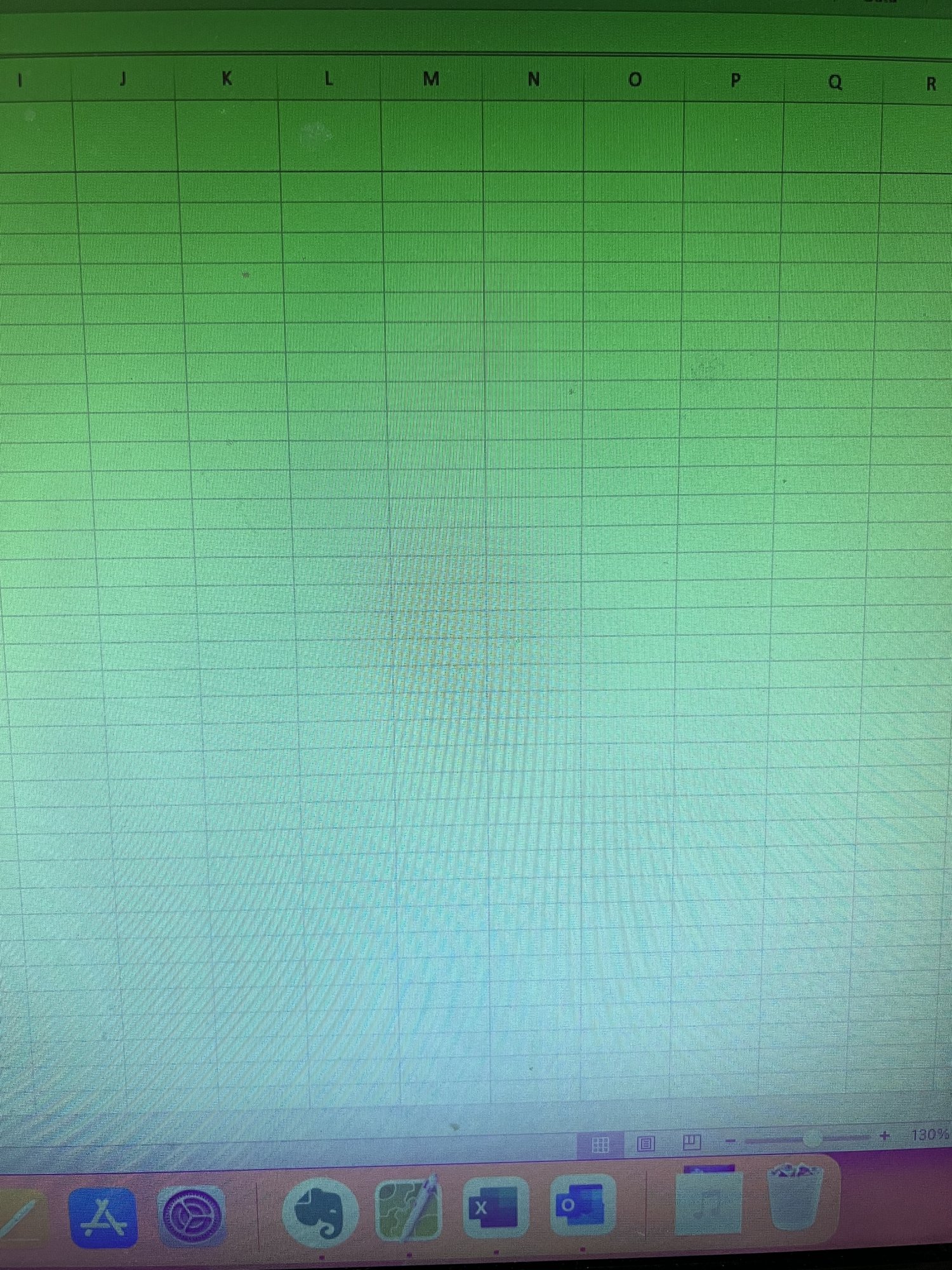

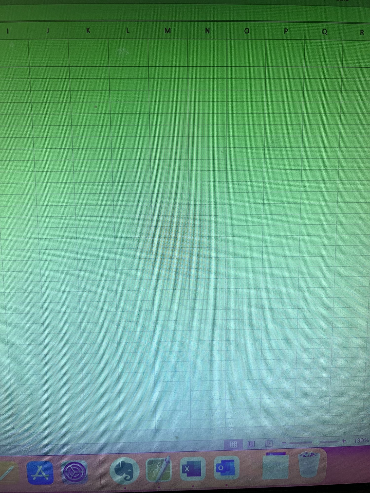

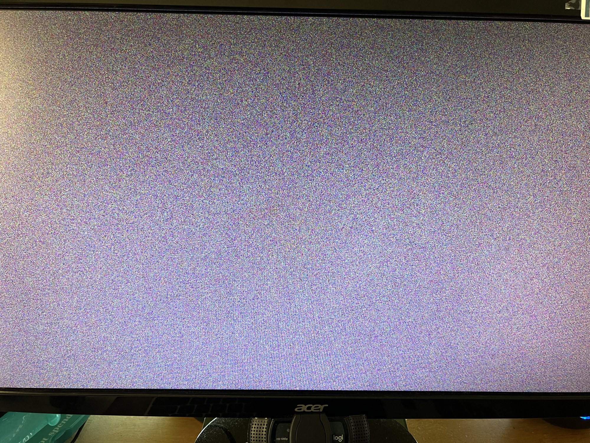

Guys - often when coming out of standby, I get a screen which is completely blank and then 30 seconds later, I get the 2nd image with a green tint later. Powering on/off the monitor or removing and reinserting the hdmi cable fixes it

Seems like a typical HDMI HDCP handshake issue, that static noise screen, a lasting solution would be switching to DisplayPort. You can google for HDCP handshake issue Mac, perhaps there are solutions...
