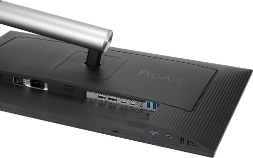

I have just received a base model MacMini M4; a Satechi hub with WD Black SSD and an Asus ProArt PA27JCV monitor and will be using it for normal office work not e.g video editing and will only use the one monitor.
I have various questions, but to start with, could someone advise which ports I should use on the monitor and the MacMini

Thanks to both contributors. I was feeling a little reluctance to use one of the USB-C ports, but hadn't quite worked out what ancillary devices I will need yet. In some ways I wish the Satechi had more USB A ports at the back rather than the front, for keyboard/ mouse type devices. I certainly don't want a stack of cables coming from the front. Surely I can avoid an additional hub!
That ASUS monitor already has a hub (of sorts) at the bottom edge?

A couple of really basic questions:
Is it the case that only way I can use the additional ports on the monitor is by connecting the USB-C between the MacMini and the monitor? i.e. Used alone the HDMI will only give video.
What is the advantage of Mrbobb's suggestion of a USB-C to HDMI cable
Yes. The display is also a USB hub. You can use HDMI for display data and USB cable to use the USB hub feature... or you can use a single USB cable for both display data and USB hub feature combined. Choices, choices.
The ports on the monitor are a hub, so they also need a connection to the computer in order to function. In this case, a USB-C to HDMI cable would not be a good choice as HDMI itself cannot power or communicate to the USB hub built into the monitor. You basically have three workable options, all using either an HDMI cable, USB-C/Thunderbolt cable, or both.
Option 1: HDMI Only (will only provide audio and video signals to the monitor)
Option 2: HDMI and USB-C cords (will also power the built-in hub on the monitor, but results in a two-cable solution)
Option 3: USB-C/Thunderbolt cable between the Mac Mini and Monitor (audio, video, and hub all working off one cable).

As noted if you want to use the ports on the monitor, you must have a usbc connection between the Mac and the monitor. Hdmi only passes audio/video.
Personally, I would use the usbc cable and call it a day. It's going to work and work reliably on the first try.

Based on previous comments, I had concluded that I should provide mains power to both the MacMini and the monitor and that I should use the USB-C for the display and as a feed to the hub that is incorporated in the ASUS PA27JCV.
Is that OK?
I am already using one of the Thunderbolt ports for the Satechi hub/ SSD and this will take a second, leaving the third free. I will have to check what other accessories might require a USB-C connection.
Is that OK?
Yes. That's the best use given your setup. Enjoy!

If you use HDMI, you don't tie up a USB-C (front) or Thunderbolt (rear) port on your Mac Mini to drive your display...but you can't use the display's hub ports.
If you use USB-C 'DisplayPort Alt' instead, you give up a USB-C (front) or Thunderbolt port (rear) on your MacMini in order to gain the display hub ports.
Since it's a USB-C display, not a Thunderbolt display, the total bandwidth of the display's video feed and data stream to/from all hub-attached devices will be limited to the USB-C's bandwidth limit. That's not a problem if you have a wireless keyboard and/or mouse dongle, an SD card reader and other fairly low demand things; if you have an external USB-C SSD or two and want to run them full speed, that could be different (and I'd probably hook it directly to the Mac Mini).
Thankfully you don't have to permanently commit. You can hook the USB-C cable up for now, for example, and switch to HDMI later. You may well already have both cables (be sure they're high enough speed) laying around.

Thanks drrich2. I will play arounf with HDMI once I have the MacMini up and running. Asus do supply both an HDMI and a USB-C cable.
A further thought re the 'HDMI' and 'Display' ports on the monitor:
Is there any point in using either an HDMI to Display converter cable, or similar converter between the MacMini 'HDMI' port and the monitor 'Display' port?

The Asus USB-C cable is what I'm using, and it's solid. My only complaint is I wish it was a foot longer, but I'm making it work fine.
