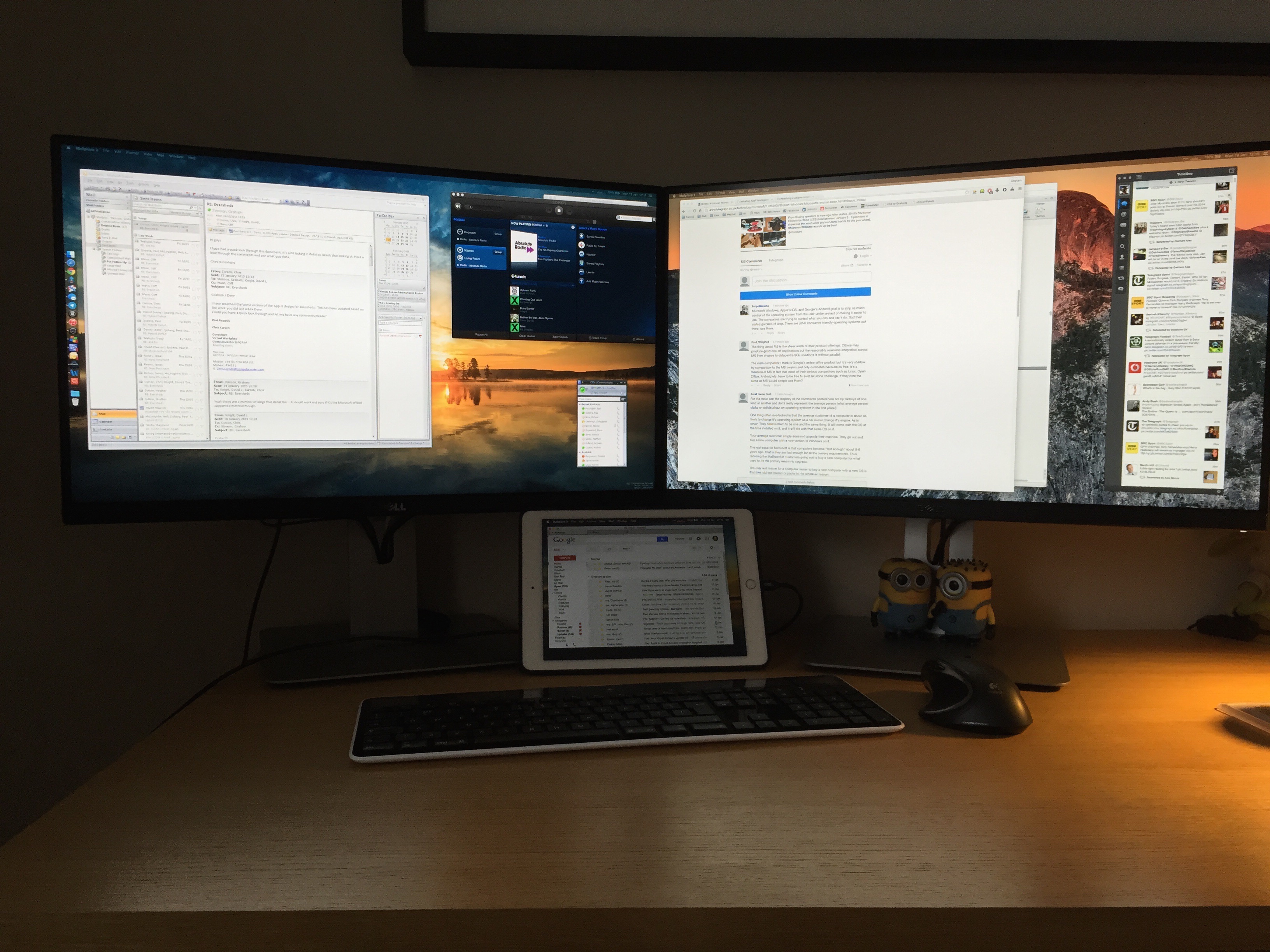

I have the U2515H from Dell I really like it with my late 2013 13" rMBP
