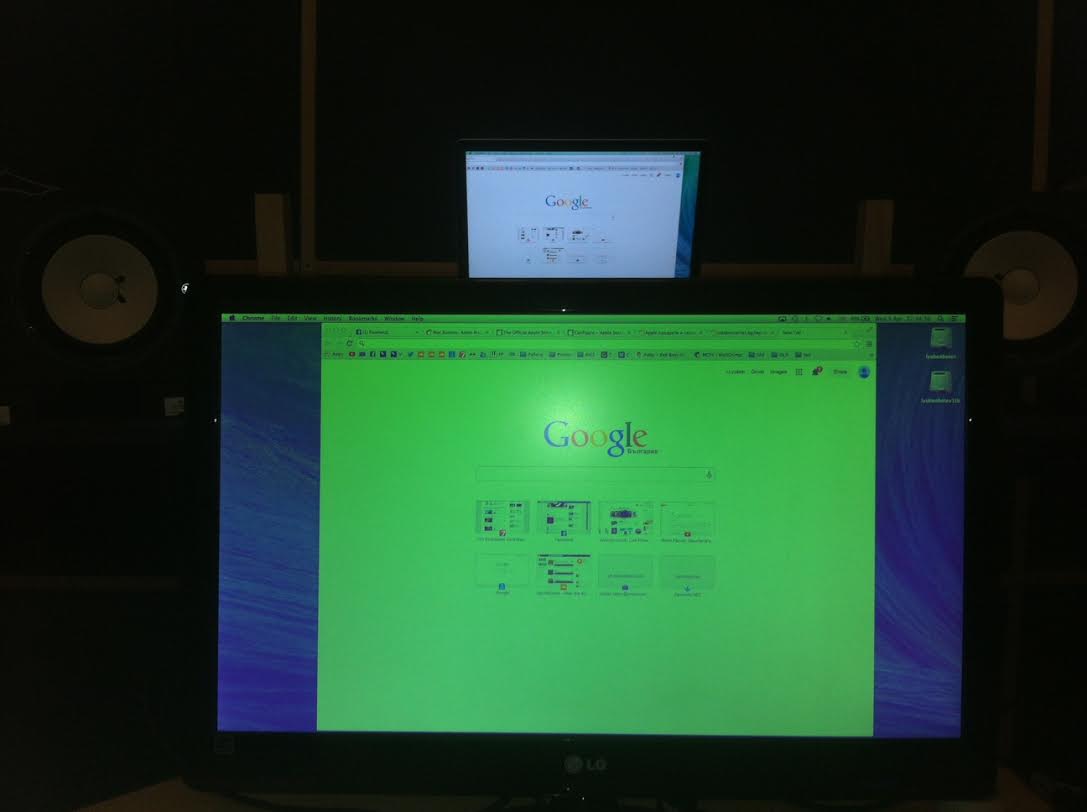

Hi, just got my new "Belkin Thunderbolt Express Dock"
When I plug my LG E2350v monitor to it. The monitor's colors get messed up.
If I plug the monitor directly to my macbook pro everything works fine.
What could be the problem?

I'm having the exact same problem. Blue channel doesn't go through the dock. In this case the monitor is an LG E2241 and the Thunderbolt connection is going through an HDMI adapter. The monitor works fine plugged directly into my MBP 13".
