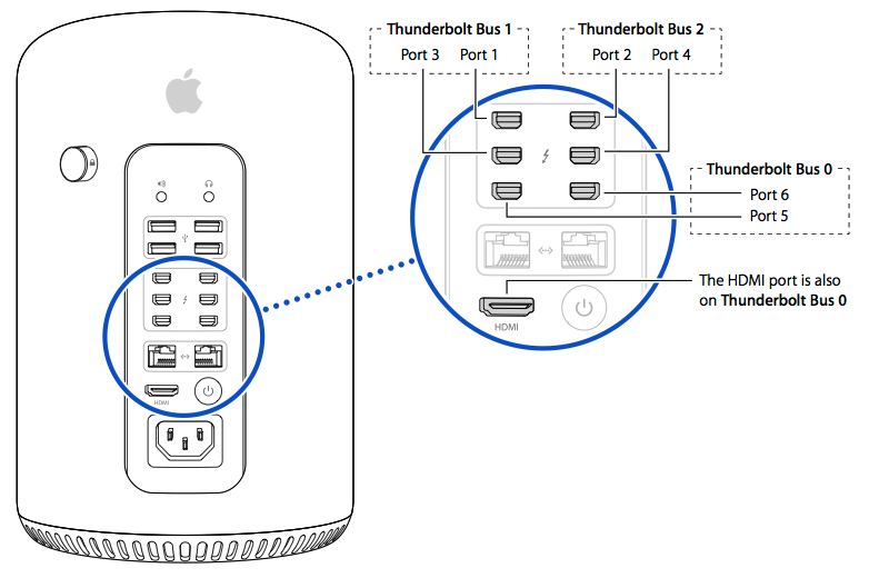

Similar problem here; 2013 Mac Pro, dual D700s, the firmware update (MP61.0120.B00 & SMC 2.20f18) pushed with the High Sierra 10.13.0 upgrade looks to have altered how my two Dell P2715Q displays are now supported/operated upon boot and following boot.
Previously, with the left display (4K @ 60Hz) connected via mDP to Thunderbolt-1, Port-3, and the right display (4K @ 60Hz) connected via mDP to Thunderbolt-2, Port-2, all was good upon completion of booting to macOS, with the left display showing the login prompt (neither of the Dell P2715Q displays would correctly show option-boot/recovery menus, requiring the temporary use of an older HDMI 1920x1080 display).

  • Moving the right display from Thunderbolt-0, Port-6

  • Set the left display to physically default as primary by moving the mDP cable to Thunderbolt-2, Port-2
  • Set the right display to be alternate by moving the mDP cable to Thunderbolt-0, Port-6
