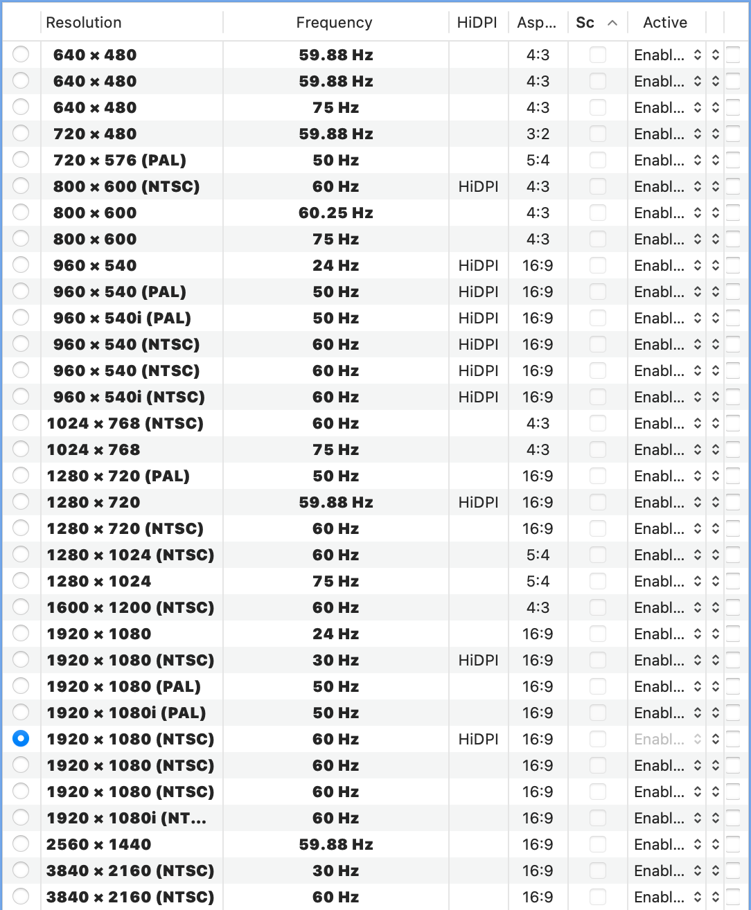

I've attached a screenshot of the recommended resolutions available in SwitchResX. I have only tried the resolutions 1024x768 and greater, and will add the following experiences:
All resolutions with HiDPI are clear and smooth, with the exception of 3840x2160 which doesn't specify HiDPI but works very well.

It's smooth at 4K and 1080p because there is no hard work to do for the GPU at those resolutions. At 4K, there's no scaling at all. At 1080p, it's exactly 4K÷2, so doing x2 on every thing isn't hard for the GPU either. With anything in-between these resolutions, harder scaling occurs, which requires more computation from either CPU and GPU. And the Mac mini 2018 Intel GPU is simply horrendous. Many 4K users with Intel CPUs report scaling issues and slower response when using different scaling than x1 and x2. This is "normal" considering poor GPU and unwillingness of Apple to optimize Metal for Intel GPU. The MacBook Pro uses Iris Pro GPU, which has more horsepower than the Intel chips in Mini. The old MacBook Air was using Iris Plus, which is also better. So the Mini is just doomed with 4K. The M1 has incredible more power and can power two 4K displays with scaling very well, resulting of it's 6x-or-whatever faster GPU than Intel.

This makes sense, and I'm just going to be doomed with 4k for the time being. 😵 But it's good to have confirmation that it's my mini and not my monitor, so thank you for that!
