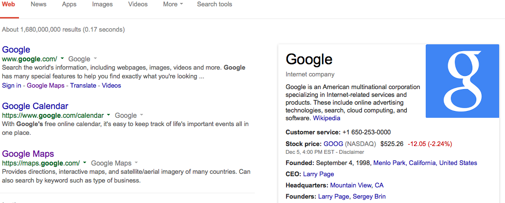

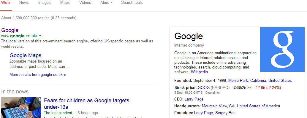

Here are two screenshots, one from Mac Mini and the other from Windows Laptop, any idea why Windows is much crispier and how to match them?
Thanks

It seems Windows renders sharper text indeed. Retina seems a necessity on OS X, which is probably what Apple wants. I know sharpness of text depends also on the browser (which was my primary reason to ditch Explorer in favor of Firefox), but it is pixelated everywhere, not just in the browser.

I guess sharpness is subjective and you might have got used to Mac (lack) of sharpness. Found plenty of evidence on the net that the two systems render text very differently and that Windows twicks font size to match pixel sise (cleartype) and make it sharper. If you look here http://blog.codinghorror.com/whats-wrong-with-apples-font-rendering/ the screenshots are exactly like the one I posted. I would say to my eyes Cleartype accounts for half a Retina display :-D Anyway it is just the text, everything else it is as sharp on the two platforms.

It is RGB thanks, the monitor is fine, pictures still look great on it. The issue is with fonts. I did a lot of research on the web and it seems that it is the way mac renders fonts that is blurry vs Windows (which uses Cleartype technology), things seem to have got worse with Yosemite, there are a lot of people complaining on the Apple Support site. I guess I have to live with this 🙁 until I get a Retina display, which is what Apple wants. Blurry fonts in non-retina to make retina shine.
