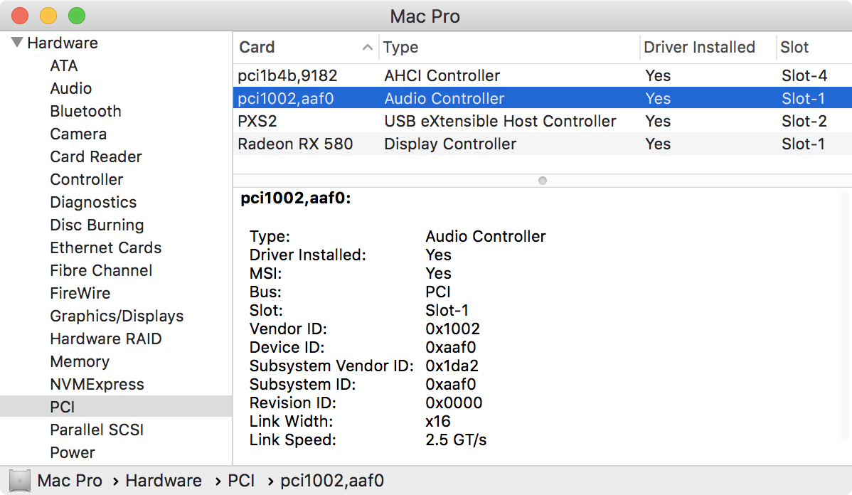

They are recognised, but should be no driver installed in your case
You're exactly right! The audio controller shows in in pci1002. Yours is installed with driver. Mine says no.
pci1002,aaf0:
Type: Audio Device
Driver Installed: No
MSI: No
Bus: PCI
Slot: Slot-1
Vendor ID: 0x1002
Device ID: 0xaaf0
Subsystem Vendor ID: 0x1da2
Subsystem ID: 0xaaf0
Revision ID: 0x0000
Link Width: x16
Link Speed: 2.5 GT/s
