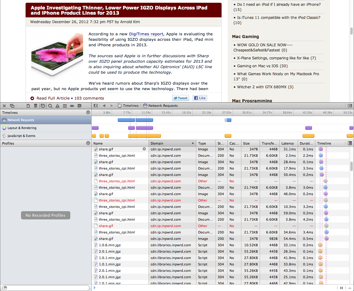

You mentioned Safari. What is wrong with using the built in developer tools->Insturments->Network Requests? (see screenshot)
You can generally see every url (full url on hover). and even see them happen in psudo real time.
Sorry i didn't explain it accurately in the first place. I can't use Safari developer tools, because i need text log file. Log don't need to be nice looking as long it logs.
