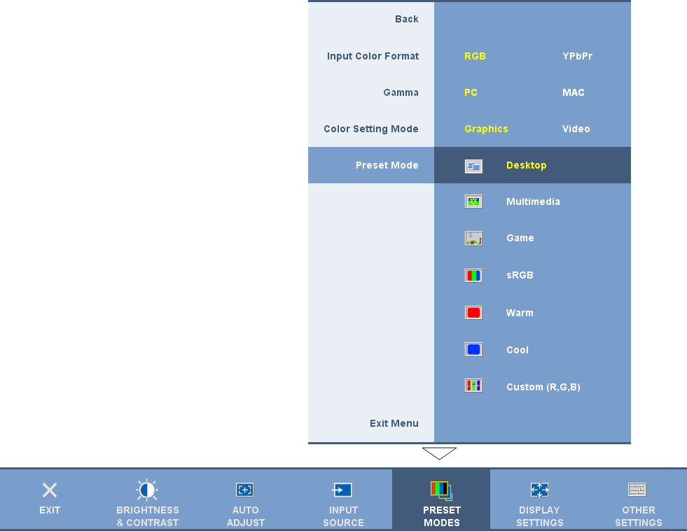

SR45,
By any chance did you go into the on screen menu and in to the Preset Mode, and go to the Gamma tab and change the PC to Mac? See photo......Just curious.......
No, but I did just now iMac Mini, to see what happens. Goodness, if this was the issue, I can beat my head against the wall 😱. Thanks for the suggestion. Will give this a test to see what happens and report back here later.
Edited: 6:45 PM---9 hours later and thus far no issues to report. Noticed twice a day prior to this update
Edited Again: Nope, this did not work. Thank you anyway for the assistance
