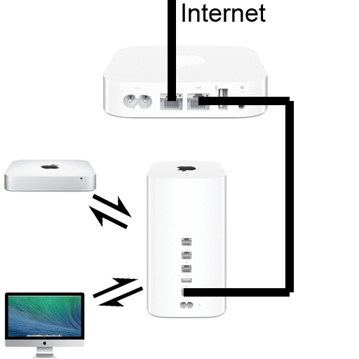

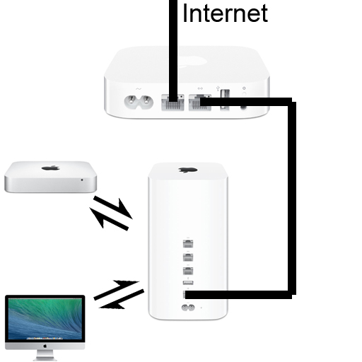

Looks like I need to brush up on my network knowledge, according to this article, I may be fine? It uses a gigabit switch with wired clients in place of the airport extreme, but would it work the same? I've also attached a diagram of what I'm thinking in case anyone was curious (obviously not to scale 🙂 ).

Turns out it's as I feared, a gigabit switch is layer 2 vs layer 3 for the airport extreme as an access point so traffic would be bottlenecked heading back and forth between the express and the extreme. Guess I'm going to have Peak Hour 3 monitor each machine individually and get the monthly totals from comcast every month. Will just miss traffic from the iPhones.
