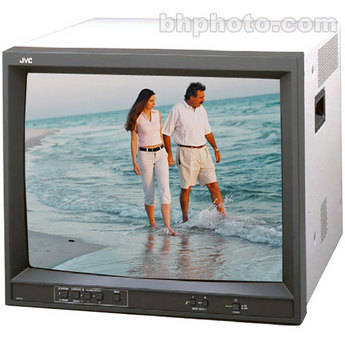

DV will look absolutely horrid when blown up on a flat panel. You need a CRT production monitor for what you do. It doesn't need to be expensive. Unless you are working in HD, this setup is completely wrong for you.
JVC makes some nice monitors that would suite you.
You want something like this...
http://www.bhphotovideo.com/c/product/286529-REG/JVC_TMA210GU_TM_A210GU_21_Color_Video.html#features
Yes i know, like I said in my original post, that´s the kind of monitor I'm used to using when I work in edit suites. But they tend to be pretty big (deep) (especially the 20"-21" inch ones) so I was thinking if there was a comparable flat screen solution for a home setup to save space?

I've got two of these JVC units, or at least a sister, collecting dust. They are nice value. But...LCD is the way to if you don't want your friends laughing at you. Only 5X more expensive! I've got two of these 2050W and they're the bomb.
Anyway... point being they make excellent LCD video monitors these days.

DV looks bad on flat panels especially if it's interlaced...you've got bigger problems if you worry about what your "friends" think of the gear you use.
If you're editing SD material, you really should be monitoring on SD screens. Besides, it's the end result what really matters. Use the right gear, not just what "looks" cool.
I work mostly in HD now, but I still get some DV work from time to time. For that I go back to my CRT, nothing beats it for DV work. Even with HD, it's nice to be able to see what it will look like downconverted to SD. A good CRT is a good investment regardless. They are cheap now so it's not a hard choice.

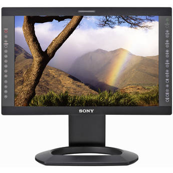

These Sony's are worth it
I can testify that these Sony monitors are amazing. Working for a production office, every station has one of these screens and no matter what resolution is being put to the screen it looks incredible. If you have the money to afford one of these monitors they are well worth it.
