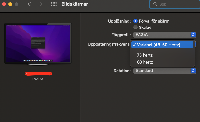

Seems to be working for me.
Turn it on on the monitor itself then go to display settings and chose variable under refresh rate.
