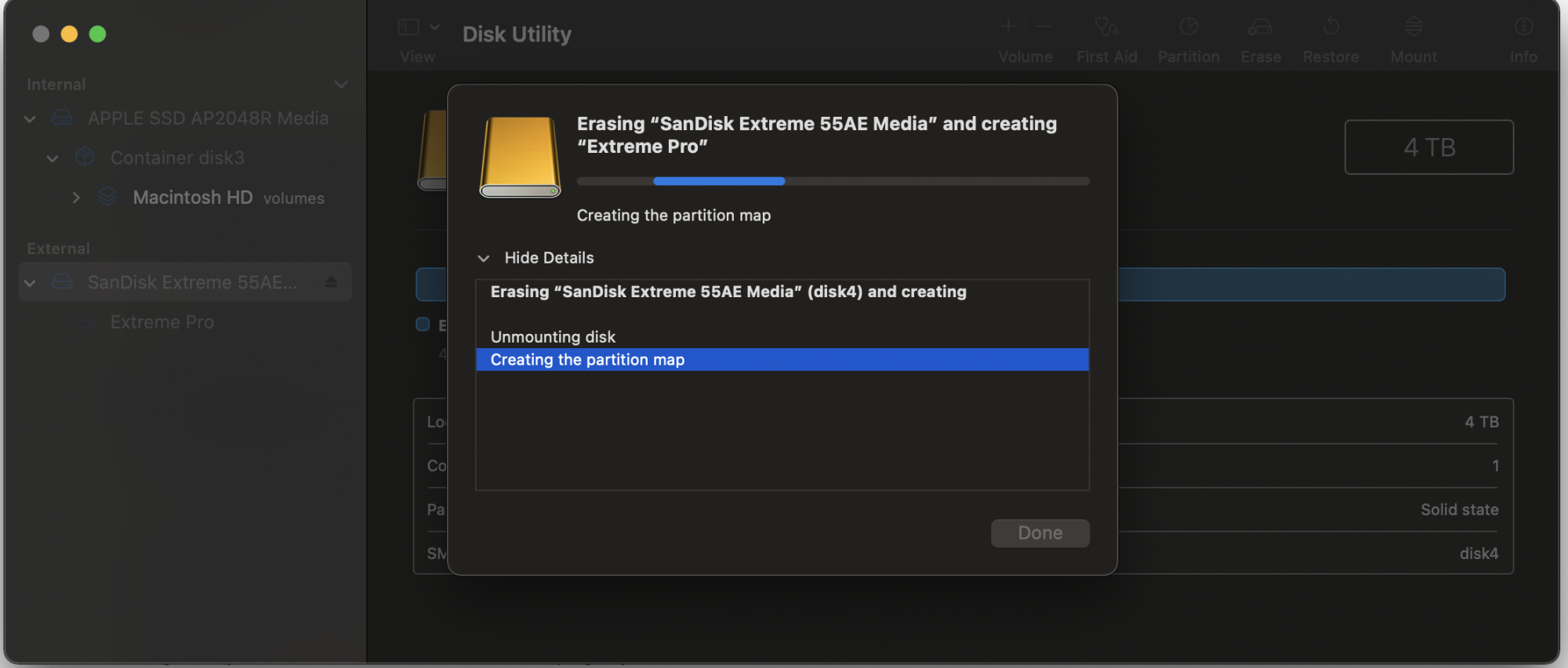

I am on Monterey 12.01 with my new 14" Macbook Pro M1 Max.
I tried to use disk utility to erase 2 of my external SSD from exFAT into APFS.
I tried the GUI Disk Utility and Terminal command, basically tried everything that I could search on Google but was not successful.
Every time MacOS just unmount the disk and process stuck there for a few hours without any progress.
Does anyone run into the same issue and know any way to solve this?
By the way very strange. It can erase and format Samsung T7 2TB but it cannot erase/format the Sandisk Extreme Pro 4TB (SKU: SDSSDE61-4T00-G25)

Thanks for the advice chabig, I basically tried every combination possible.
1. erase the disk and erase the volume itself
2. Tried to erase in the Disk Utility GUI mode/Terminal command/Recovery mode Disk Utility
3. Tried to erase into all combinations of GUID parition/MBR/Apple MAP
4. Tried to erase into all combinations of MacOS Journaled(case sensitive or not)/ExFAT/APFS(case sensitive or not)
5. Tried all the USB cables, all different ports
6. Tried to directly connect the SSD to the MBP ports/connect via Caldigit TS3 Plus dock / Connect via Elgato Thunderbolt 3 Pro Dock/connect via Belkin USB-C hub/ connect via Hyperdrive USB-C hub.
7. Tried first aid/fix permission
I basically tried every method under the sun that one can google and I am sure the SSD is 100% working, I can read/write perfectly fine on both Windows and macOS
I can delete volume, secure erase, partition, create volume, format...everything on Windows.
Sadly I don't have the 16" MBP under BigSur with me anymore, so I cannot verify if this is a hardware compatibility issue or a Monterey bug 🙁

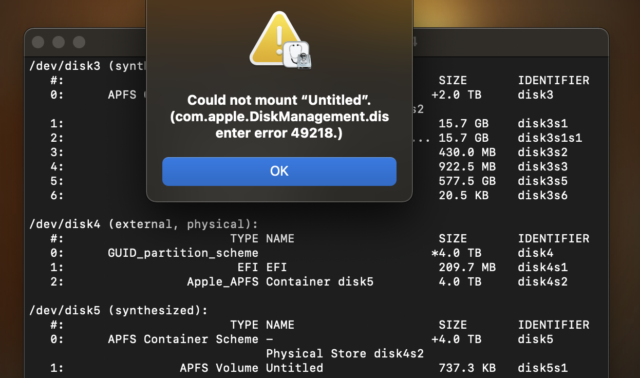

Yes, I did, I erase on another Intel-based MBP 13" under Big Sur erase and formatted it into APFS and 2014 Macbook Air running under El Capitan erase and format it to macOS Journaled.
Both took like 3 seconds to erase and format and automatically mount the drive after erase/formatting.
But after that I plug the formatted drive to my new 14" MBP, it won't mount like below screenshot
I also tried to format it into ExFAT from Windows PC, no problem at all but it won't reformat as HFS+ or APFS on the 14" MBP.
But the 14" MBP can successfully mount and R/W under the PC formatted ExFAT.
