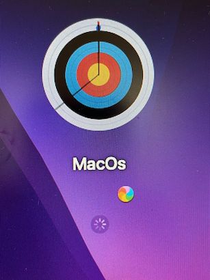

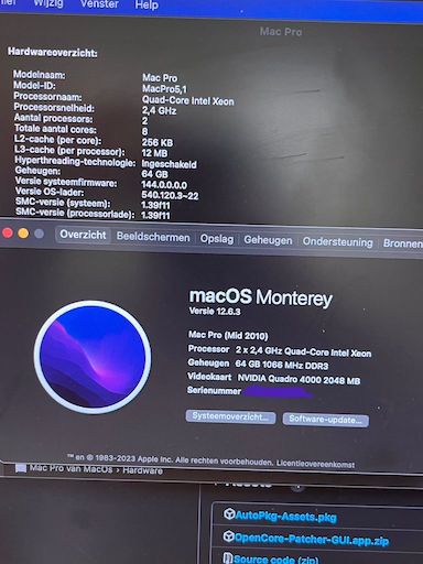

Running Monterey on a MP5,1 with OC & OCLP 0.6.2. All starts well including login. Then after logging out and try to login, nothing happens (spinning wheel forever).
Any ideas?

To be clear, are you entering your password and then beachball, or do you get the beachball immediately after logging out?

I got the beachball directly after I typed the password to log back in.

I didn't try to add the user account as you mentioned, installed another graphics card instead. Ran the OCLP post-patch and it turned out to solve the problem.
Must have been something with the drivers I guess. May try to switch back to the Quadro 4000 later to see if the problem comes back.
Reactions: bookemdano
The Quadro 4000 is no metal GPU and needs a pile of patches to run in systems newer than High Sierra.
So you get all sorts of oddities with root patches, need to unpatch if you change the gpu to a Metal capable one and need again to patch for a pre Metal era gpu.
