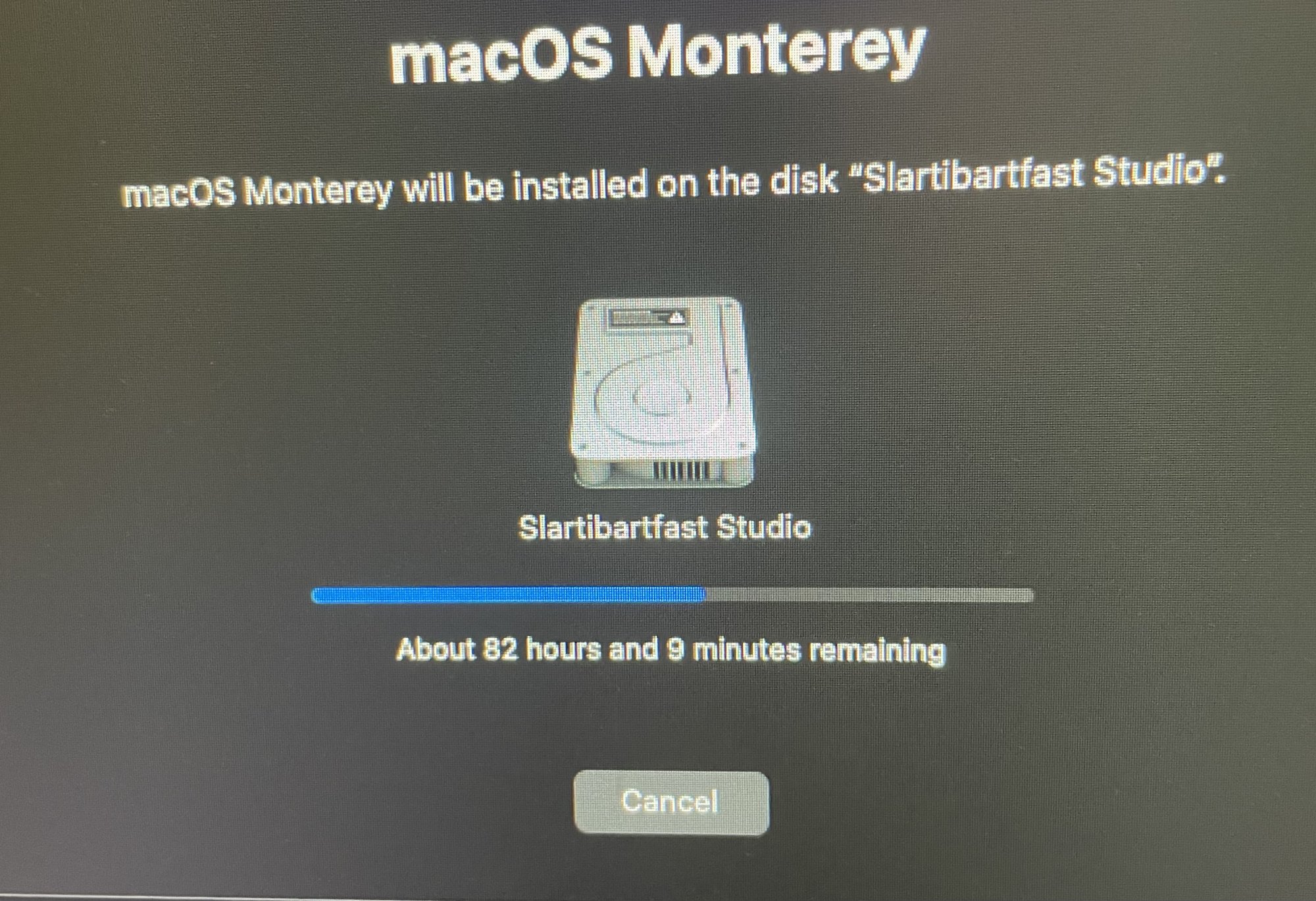

I decided to reinstall Monterey on my two month-old Mac Studio because of myriad problems I’m having with it (endless SBOD, applications locking up and not responding, continually losing contact with external drives). From the Recovery Partition, it told me that the process would take over EIGHTY HOURS. The first time, the next morning, there was no signal going to the monitors, even after unplugging and replugging them into the Studio, turning them on and off. Turned the Studio on and off, and it wouldn’t start up. Progress bar got to 20% and wouldn’t go any further. Reinstall again, get the 80-hour message again. In the end it took about twenty hours, but still that’s an unacceptably long time for a reinstall… however, at the end of the process, the Studio still wouldn’t start up: the progress bar just stops at about 20%.
I tried restoring from a Time Machine backup (from the Recovery Partition), but it said that I would have to use Migration Assistant to do that and to do that I’d need to reinstall Monterey…

If you made a bootable USB installer, did the reinstall go any faster?
If not, you may simply have an internal flash storage issue, and Apple would perhaps need to replace SSD or logic board.
With your existing issues - it does sound like you will be able to use your warranty...

I’m going to leave it run from the Recovery Partition: it should complete by morning, here. If it doesn’t work, I’ll try the bootable installer. It certainly seems that I’ve got a ‘Friday-Afternoon’ machine here…
I have found any installation time estimates to be ludicrous. Yours is probably estimating based on some slow network.
That being said, I prefer to use a USB installer for recovery. It gives me more control over the process. Actual install is less than an hour. Application Migration might be more. But on a 2TB plus content system is has been < two hours with fast drives.
Something is definitely weird on your network. I ran into intermittent issues on mine (wired and WiFi Erro 6 Pro) that turned out to be a bum cable for my MacBook Pro on the Switch! Switch ports should not impact each other, but one of them might have been spraying noise. I am replacing the old Netgear 1GB unmanaged with a managed switch for better debugging.

Well, the reinstall from the Recovery Partition failed: no signals going to the monitors this morning, so restarted. As before, on restart, the progress bar gets to about 20%, then hangs…
So, tried with the bootable USB: everything came up in the disk picker. Clicked on ‘Install MacOS Monterey’ then it went into ‘Discovering Volumes’. FOR OVER AN HOUR. Finally managed to select my startup volume, clicked install. Time estimate: 55 minutes, so I’m assuming that it’s booting from the USB.
Walked away for about an hour, come back to… a startup progress bar stuck at 20%… seriously, this Mac Studio has been a POS since day one…
