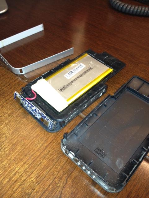

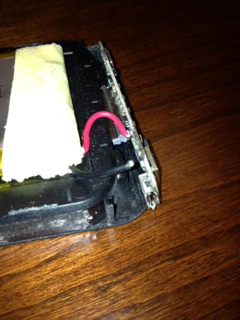

    If like me you run across this same issue and can't return the item bc you not longer have the receipt this may help. Looks like the issue is that one or both of the wires from the battery to the board has come off. This most likely will void your warranty and may not work for you, so if you do do it do it at your own risk....
    I ended up cracking open the case, it's not too hard. Remove the outter plastic piece that goes around the bottom half of the case. Mine was grey. I used a push pin to loosen the glue that was holding it on. Careful taking off this off around where the USB port is, can break easily. Once that's off separate the the back part of the case from the inside half that holds the battery, used the same push pin. You should now have a two parts, one that has the battery and board with the lights and the other back part. Make sure to not loose the on/off rocker switch. Solder the wire back and you should be in business...
    Worked for me hope it works for you...
    Here's a couple pics showing me taking it apart:
