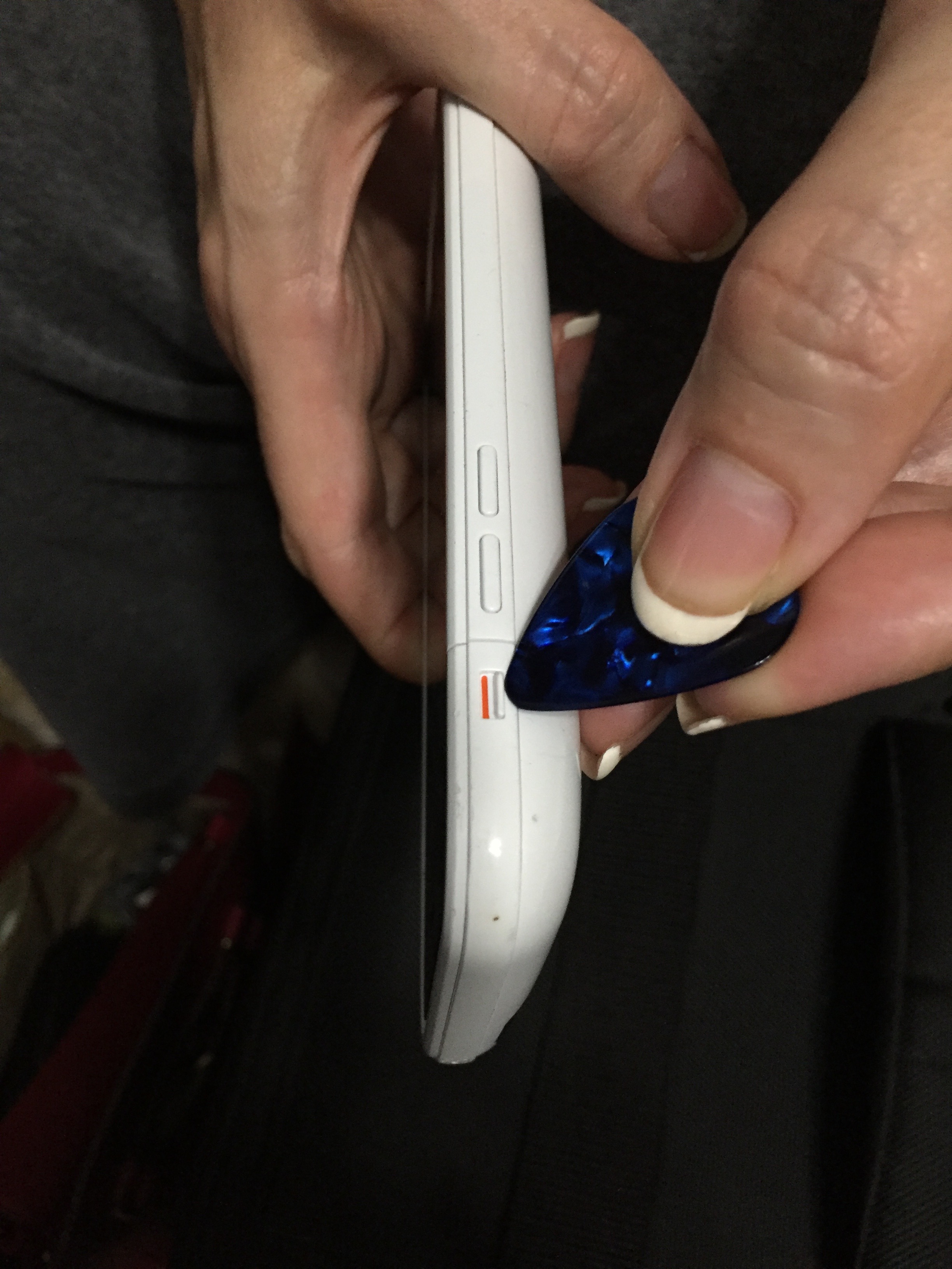

Will you send me a picture of where we are supposed to shave a little off?
A picture would do little good. But here is one anyway. The area to shave is where the guitar pick is
Try to imagine shaving some plastic away from the side of the hole the switch is in to allow the switch to travel further toward the backside of the phone when in Mute position.
Clear as ketchup?
