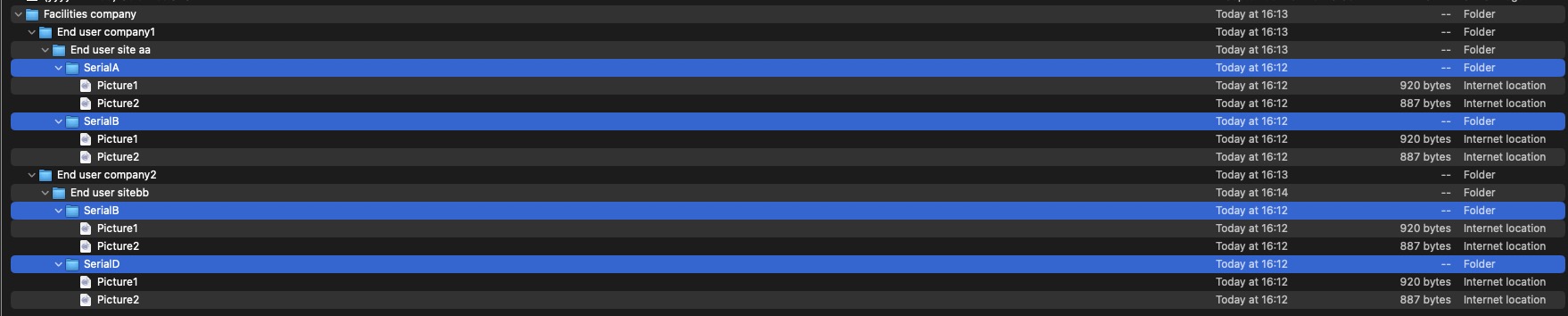

Thought I'd better explain with a picture, should make things clear.
The idea is to end up with a list of serial numbers which of course would be a list of every unique item that I have pics for. The only things I want to appear in the list are the highlighted ones.

In your example just above, SerialB occurs within both "End user site aa" and "End user sitebb".
How do you want this handled:
(1) "SerialB" occurs once in the output list,
or
(2) "SerialB" occurs multiple times in the output list (once for each End User Site it occurs in)

Hi there Brian, thanks for your input.
Serial B needs to appear as many times as necessary. (Some items have the same serial number and some have none so each item will be given an identifier that is unique to distinguish them).
I think if I get the folders to have the full path the I'll see the differences.
