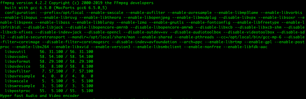

4.2.2 is include in the app from @alex_free :
Thx for the shoutout. By the way @TzunamiOSX python is not required for building ffmpeg it’s all autoconf. Check out the PPPCMC source to see how I targeted a universal G3, G4, & G5 PPC Arch for Mac OS X 10.3.9 for the latest FFMPEG version (4.2.2) using just Xcode, no MacPorts.

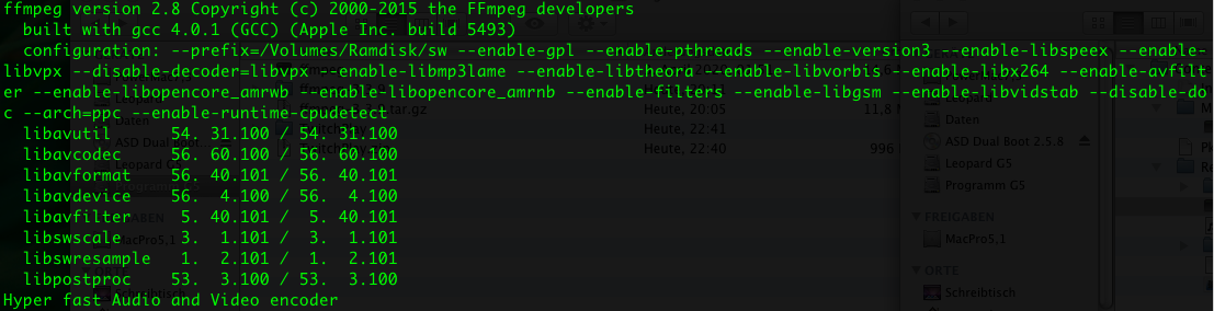

Python is a needed part when compile with macports, target is a version with all parts interated like this:

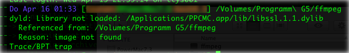

Looks like FFMPEG from PPCMC does not work us stand alone and need parts inside the PPCMC app

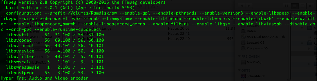

I need a stand alone version to replace ffmpeg by an "optimized G5 version" in some programs like remux.

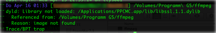

Looks like FFMPEG from PPCMC does not work us stand alone and need parts inside the PPCMC appView attachment 906231

It’s not going to work stand-alone because it’s linked to a bunch of libraries...
You could static link your own build (that is not how I did PPCMC) to achieve this.
When I suggested PPCMC, I figured you just needed the program. With a PPCMC Shell open ffmpeg <arg> works fine.
