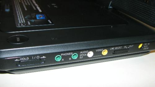

The sony DVD Player has Video in port, it looks just like the one you plug your headphones. Dont know how to call it, for sure is no Composite or Component.
Wait I found a Pic, is the yellow one... I need to hook up my iPhone to this port

Read the specification on the DVP-FX820
Accessories Supplied
* Remote Control, Batteries for Remote, Owners Manual, AV Cable, Rechargeable Battery Pack, AC Adaptor, Car Battery Charger
Inputs and Outputs
* Composite Video Input(s) : 1 (with Line Input/Output Select Switch)
* RCA Audio Input(s) : 1 (with Line Input/Output Select Switch)
In other words it should have come with the cable you already need to connect a composite video source

Why are people so lazy that they can't even take a look at the Pictures that the OP posted?
they call AV Cable to a cable that has:
A MALE 1/8" jack that ends up in a MALE Composite cable (x3) that is intended to connect the OUTPUT of the DVD Player to a FEMALE conector in the TV.
If I buy the Apple's Composite iPod Cable I will end up with another set of MALE Composite connections...

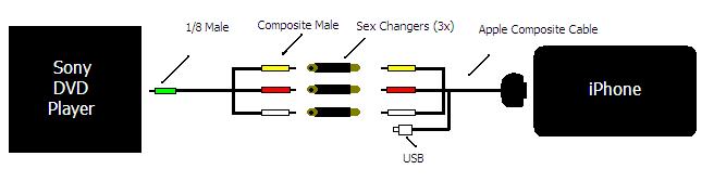

Here's what you are going to need *(my laptop doesn't have photoshop 😀)
attachment.php
attachment.php
I don't think that's what you want! (unless your DVD player has all 3 signals going into the same 1/8" jack)
In all likelihood, the video has it's own mono 1/8" jack, and the audio is carried in via a separate stereo 1/8" jack.
Your picture I don't think will play out well. Hopefully Radioshack will have caught this and corrected you.
Uh oh. Radioshack - You've got questions, we've got blank stares.
Umm I made that pic in MS paint, not RadioShack.
I'm pretty sure that's the AV cable he has, he stated
"A MALE 1/8" jack that ends up in a MALE Composite cable (x3)
then you just need to be sure the switch is on input
