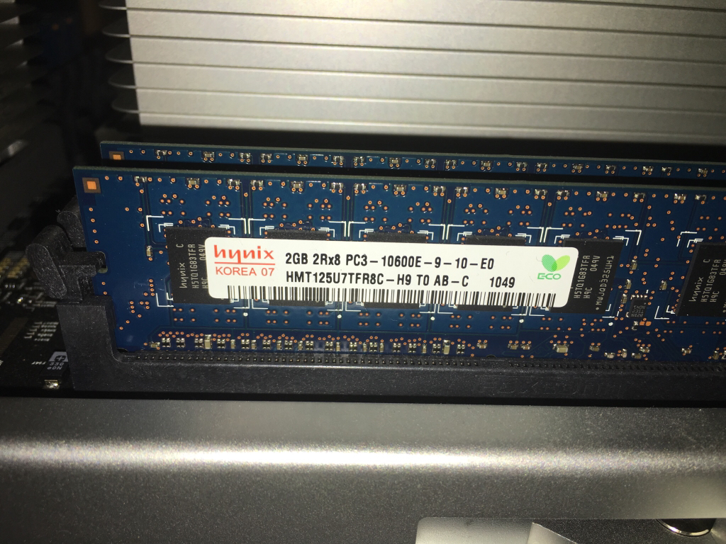

Thanks. This is a photo of my current RAM. What's does the "1049" indicate to the far right. I found someone selling 4 more sticks but the number on theirs is "1034". Is this just a lot number, set number?
Yes would be a lot number the important parts you need to look for is the 2Rx8 the R being registered ram then the PC3 = DDR3 ram the 10600 the speed the 9-10 being the latency not sure if the E0 is part of that or not but the latency like the speed will drop back to the slowest ram in the machine. The second line is the part number, oh and the PC3-10600 is already 1333mhz ram in there. If the rest of the numbers other than that lot one match up then you should be good to use it. Do you have link to the modules you are looking at?
Edit: That is definitely not the original ram there were 6x1GB in there from the factory you have 4x2GB in that now for your 8GB.
Your welcome. Those should be what you need they are identical except for the lot number on them.
