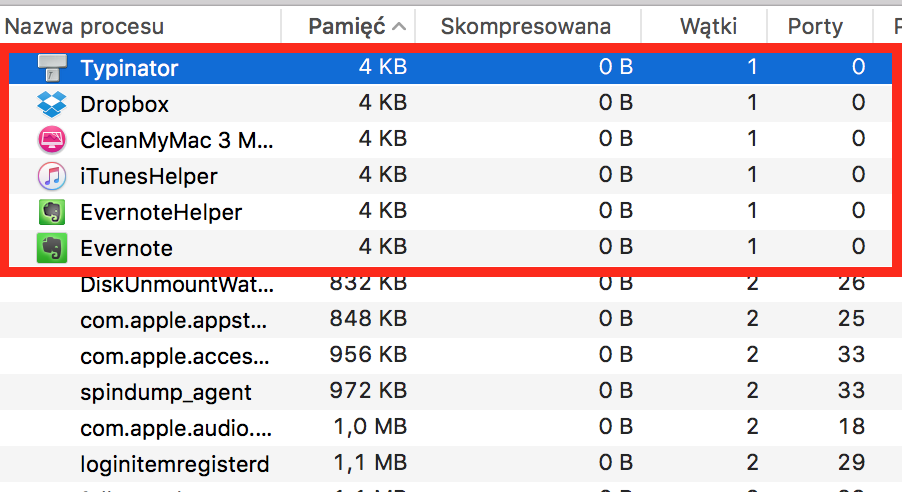

Same here, at every reboot some random apps from startup login items doesn't start up. I need to force kill them in Activity Monitor and relaunch to work. Even then when I try to launch for example VLC sometimes it launch without any issue and sometime it doesn't start at all and VLC icon is bumping in dock for infinity.
Any strange thing I found out is that apps which doesn't start in Activity Monitor are always using 4KB of memory and only one thread.

Let's see if the others are also using Hands Off
Ok, I did quick test. I unistalled HandsOff completely and my problem with stuck apps was gone for good, I did few reboots and no problem at all. And then I installed HandsOff back again and problem is back again - random apps stuck when starting.
So I'm 100% sure HandsOff was causing my problem.
