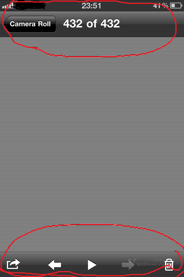

Hi all,
I have noticed some very fine horizontal lines on my iphone4 screen with IOS 4.3.5,Its not as silky smooth looking as it was.
they are very fine unless you look carefully you can see a lot of thin horizontal lines on the entire screen.It is a very persistent flicker with flashing horizontal lines on the whole display.
Do you guys have this problem?If you can‘t see it ,use this picture to test it.Save this picture( Full-size image with 640*960,not the Thumbnail) to you camera roll or photo libray,then check it without Zoom in or out,you would see the top and bottom bar flickering.

I dont know Whether its the hardware or software problem,but its the most obvious when unlock the screen.After keepping the screen on or play some video ,it may disappear.
Wow, you're right. I can see clear interlace flicker when viewing that at actual size. Very curious, wonder if they're drawing alternate lines to keep performance high on the high res screen?
Not that it'll make any difference at all 99.9% of the time of course. The effect is slight, and only visible with a test image like this or under very rare circumstances. I mean I'm pretty sensitive to this and can see the screen flickering clearly with that image, but I'd never noticed before now.

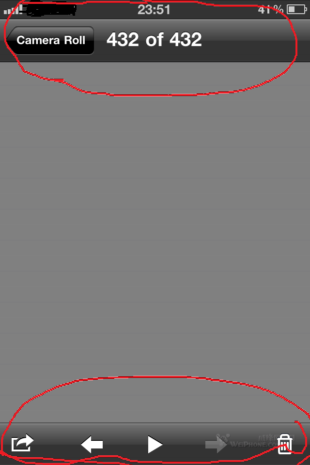

The top and bottom bar flickering is more obvious
troyy: the top + bottom bars are much less obvious to me. The image alone clearly flickers, but I can't see any flicker in the bars.
